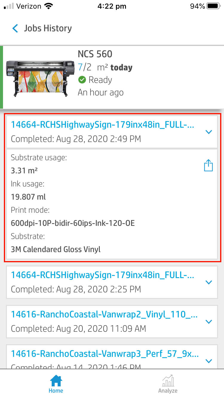

    RIP-based job costing tools are predictive in nature.
    With HP Latex, you have access to additional tools like the Embedded Web Server, and PrintOS PSP App. One is accessed from a browser on the local network, and the other is accessible on your smartphone or tablet from anywhere in the world where cellular data is available. Both contain very accurate data on ink consumption (by color and in total) for each job and in aggregate. See attached screen grab for PrintOS mobile app that shows ink and media use.
    Accurate historical ink use data supports forward-looking job costing/ estimating.

    Ah thanks for this. I heard a lot of mixed reviews from people about the mobile app. So will this be able to tell me what the coverage would be prior to printing?

    No it's only post-printing. None of the RIPs can tell you ink usage of a 3 or 5 series machine since they are contone printers and the ink build mapping is done on the printer itself unlike halftone printers.

    Did you download and configure the HP latex mobile app on your cell phone? All of your usage is displayed right there in the palm of your hand.

    I am curious about this - what 'mixed reviews' have you heard re the mobile app?
    It is the only truly mobile application in this market segment (AFAIK) that allows the user to monitor their printers in (near) real-time from literally anywhere. In addition, it provides robust reporting and telemetry data with 5 key performance indicators, consumables reporting, daily print volume notifications, and more.
