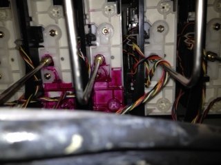

Before I had a chance to do anything with the swapping of the heads, I came in and found this one day last week. It appears that at least one of my new 440ML magentas decided to take a leak through the back of the cartridge bay. I'm pretty sure it was just one and that the ink seen on the right magenta cartridge is leftover, because I remember seeing that before. The one on the left, on the other hand, was empty when I pulled it out. The ink ran down the back of the machine and all over the floor.
The machine was turned off. I am running the latest firmware.
Questions:
Could this have anything to do with the magenta drop out I keep getting?
What could have caused it?
What is the fix?
