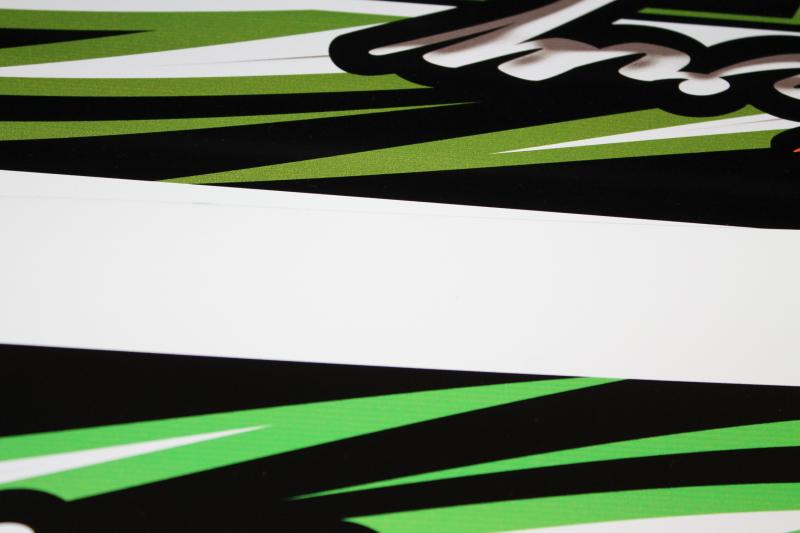

I just replaced all 4 inks in my 300V - replaced with 440ml Eco-Sol Max - same ink I have always used. I have 2 issues:
1 - when I click down on Menu and Ink Control - the machine acts like I do not have new ink, there are no bars next to 1 2 3 4 - it doesn't beep and not let me do anything like when I ran out, but it doesn't show that there is new ink installed since again, there are no ink level bars.
2 - I ran a test print, a normal cleaning, printed 3 items at smaller scale and noticed it got better, but the ink is still way off. Printing a sign I was printing when I ran out - same profile, settings, etc. and look at the difference in the greens! The bottom was before my ink ran out, the top (darker green - this is supposed to be lime green) was with the new ink. Before I printed this final one I did a Powerful Clean as well......
Any suggestions? Thank you!

Have you turned your printer off since installing the new carts?

Nozzle print was fine.
Yes, Roland Ink - not an off brand.

Green is better - but still not as bright as it should be - considering the first one was done with same profile and settings. I closed down the printer and VW and reloaded everything with same settings and still not getting the same as before....

I did - wasn't quite sure how much to "shake," - ha. I probably did similar to what I did before.
After multiple runs it seems to be improving - so not sure if it just took a while to get a constant flow through the lines.
I am concerned about the machine not recognize that new ink is installed though - as there are no indicator bars next to the 1 2 3 and 4.
Anyone have any solutions?
Thanks.
