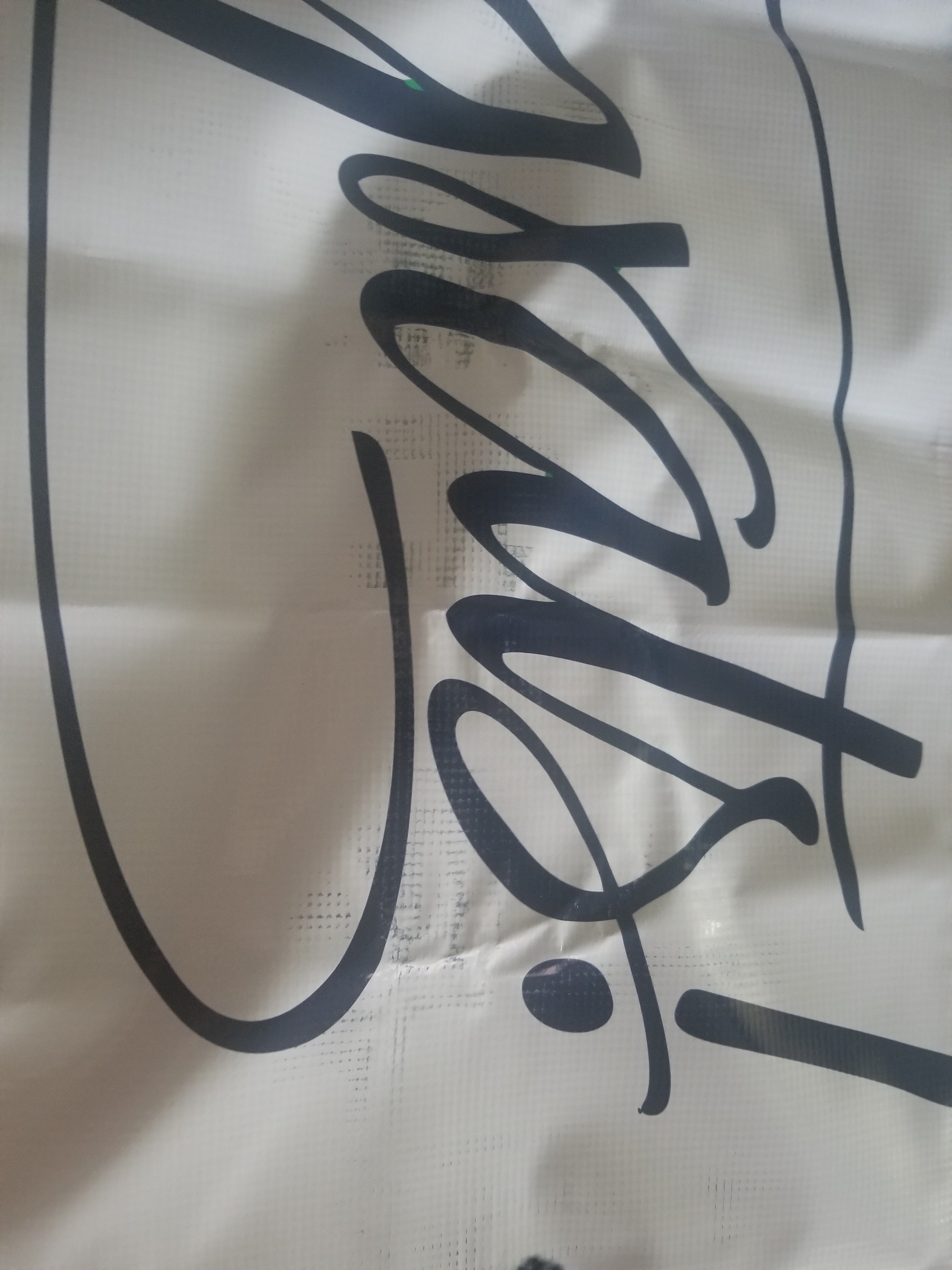

    I am printing with a roland xr640. New machine bought back in June of last year. All we are printing is banners, using arlon banner. I am printing on high quality, with the max temps. We are hanging them to dry for a day or two, but their sticking together when we ship them and ink is smearing. Any ideas on what could be wrong? I'm thinking I may need to either put some heaters in front or invest in one of the heaters that go across the machine and blow heat down on it but I hate to spend that much.

    I've actually found that high quality uses a tad more ink (according to versaworks) than normal quality and it takes longer to print exposing the print longer on the heater. Also when printing on normal, I see banding (even brand new, it was doing it) and the dealer is clueless on what to do. There is like lines running through the print on normal, even on other material we print on, on all files.
