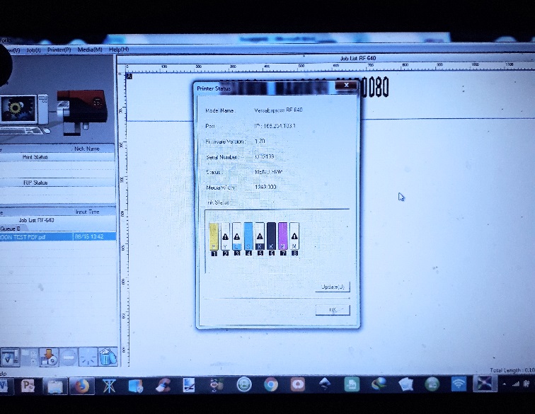

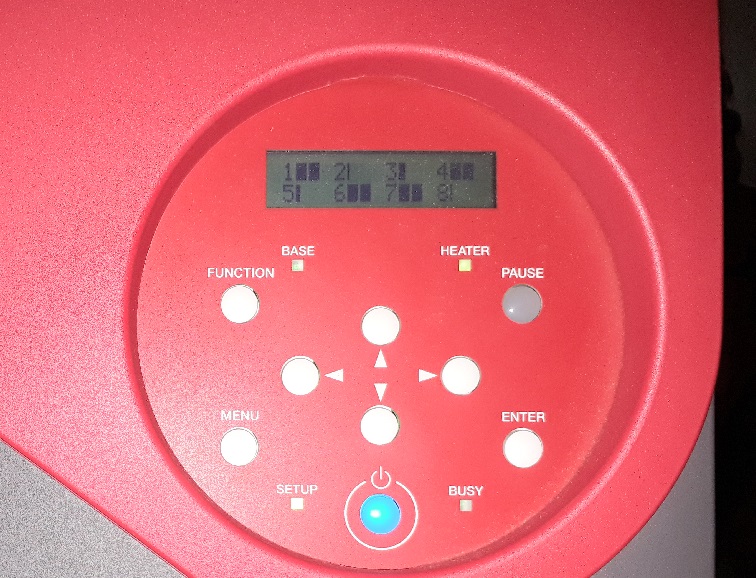

Versa works and indicator on Printing shows half of the cartridges still full but Print results shows missing colors and drop outs. Done cleaning (normal, medium,full,light choke and manual cleaning but results still the same. Why is this…?

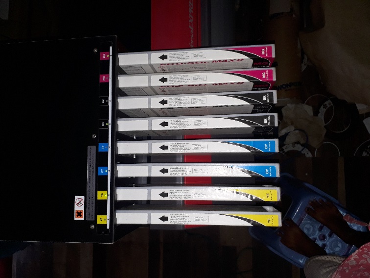

Cartidge ink status.
Yellow 1 still full , Yellow 2 Empty
Cyan 3 Empty Cyan 4 still full
Black 5 Almost Empty, Black 6 Still full
Magenta 7 Still Full, Magenta 8 empty
(Picture attached showing ink remaining in Print and by Printer Status on Versa works…
The print out we get shows poor quality or no colors…
Versaworks prompts that there is insufficient Yellow and magenta Inks ….?

The ink system on these printers only guesses at the quantity available. They can be close but are rarely spot on. Take the cartridges out and rock them back and forth. You will be able to feel if they are empty or not. The machine does have hard stop if the cartridge is empty which is a sensor that the cartridge physically flags but sometimes that doesn't work properly especially with 3rd party inks. If a cartridge emptied without flagging, that would cause drop out for sure.
That being said, most of the time drop out is from bad maintenance parts that have not been changed for too long or are dirty.
