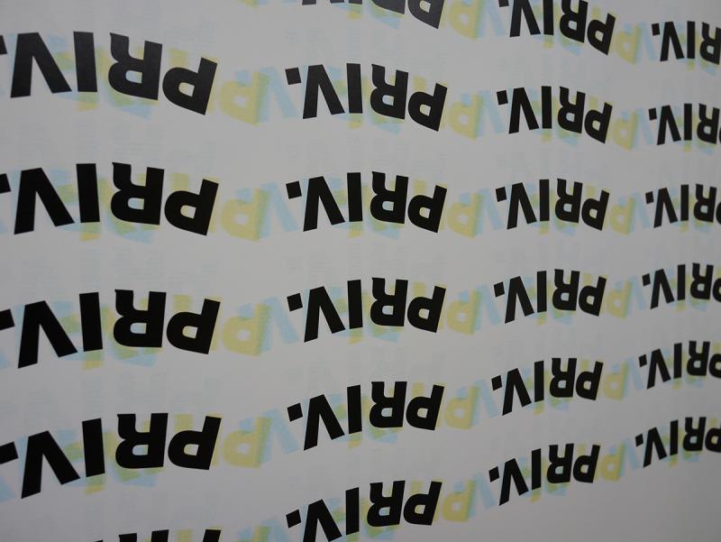

The reason I ask is that today I had a really odd blue & yellow ghosting thing happen on a black-only print (100% RGB black) - and my rep said that it could be due to a low cartridge.
here's an image:

no that's a versaworks issue, I've had a few files do that to me recently, I sent the files to other shops in the area running versaworks and they all had the same issue, but shops running other rips printed the file fine.
try pulling the file into your design program and saving as a different format, that's the only thing that worked for me.

The file has since been deleted as the customer changed their mind on the wording, but I wonder if the issue is in the fact that I had applied an RGB black to the lettering as opposed to CMYK?

that ghosting is odd, none of our files are doing that 95% of them are PDF files

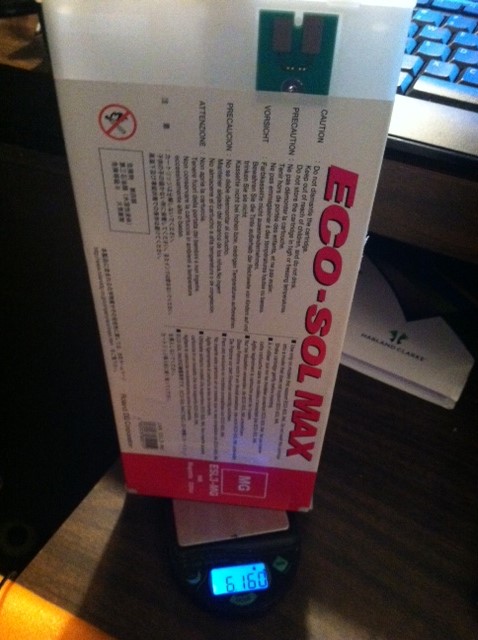

I just wanted to be darn sure that the printer will indeed stop and ask for a new cartridge, as it did before. I'd hate to run the lines dry!
I used to weigh cartridges before I trusted that the "empty beep" worked. I now trust the beep, but if I plan on being far enough away to not hear the beep, I will weigh the low ones.
Empty 220's range from 6.125-6.195 grams.

What was the FORMAT giving you the problem, and what FORMAT did you change it to that eliminated the problem?
Just in case I ever get this issue, thanks...
:notworthy:
all occasions recently happened with customer supplied pdf files, all were also created on a Mac. both times I pulled the files into CorelDraw and saved them as .eps files and it fixed the problem.
