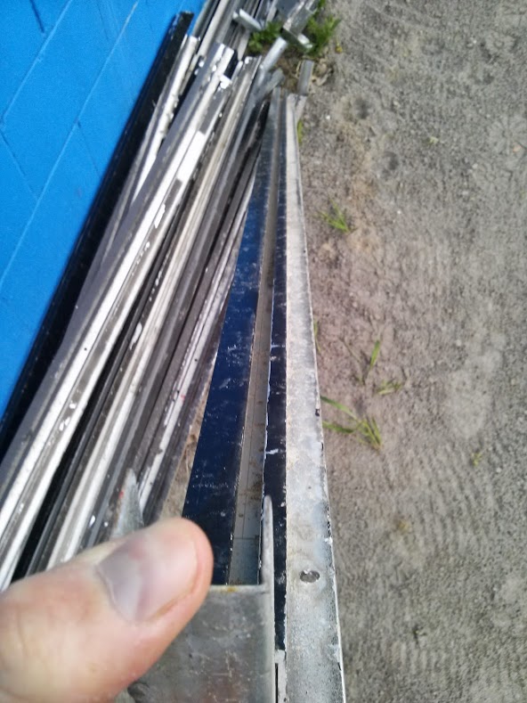

    Here's what they look like
    To me this is designed for Acrylic or something similar.
    Of course they tossed out all the screws as well.

    Pretty sure it's a Proveer extrusion for rigid faces.

    So apparently the job was incorrectly done on Banner materials and the previous vendor has agreed to redo the signs in backlit.
    Making my life easier. Thanks to Laird Plastics here in Ottawa I got my sign white acrylic all cut up and ready for pickup.
