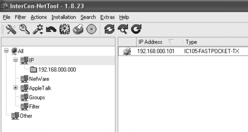

After hooking everything up, I open InterCon-Net tools software & see that I have an IP address of 192.168.000.101 & it shows that it is connected.

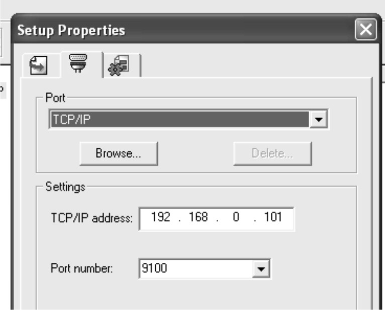

I open Production Manager & set the printer to TCP/IP & enter the same ip address & hit apply then ok.
When I try to print, I get the message "Cannot Open Port" under status.
I can successfully ping the IP.
Also the IP of the NIC card is 192.168.000.100 so the IP of the printer should be correct at 192.168.000.101
Is there anything else I should check or any setting in the router itself I should check?

do you have any way to confirm the ip address of the printer in question? try pinging it to see if it is the correct ip address, you can also try changing the range and dhcp settings in the router the 000 octet might be an issue.
choucove
Depending upon how the router is connected with the rest of the devices, you might have to configure port-forwarding as well, though that is most likely not the case.
As stated above the 000 octet might be causing an issue with some devices. If you can get into your D-Link router, set it's default IP address to be something such as 192.168.1.1 and hand out dhcp IP addresses in a range of like 192.168.1.100 - 192.168.1.150. If your computers are not receiving their IP addresses from the router (either static IP addresses have been set or another device is the DHCP server in your network) then that is another issue.
