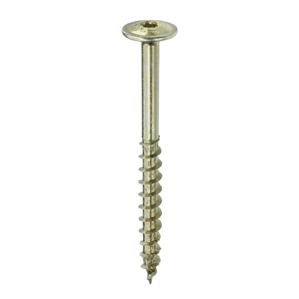

If they're going to be 'really high up', no one will notice the fasteners if you color match them. I would get some Spax #10 x 3" screws for 'multi-material' from Home Depot, paint the heads to match something near the four corners of the boards, and install with one screw per corner.
Bring a template (cardboard, paper, etc.), hang it on the wall, drill your holes, hang your boards. Easy install, easy removal.
