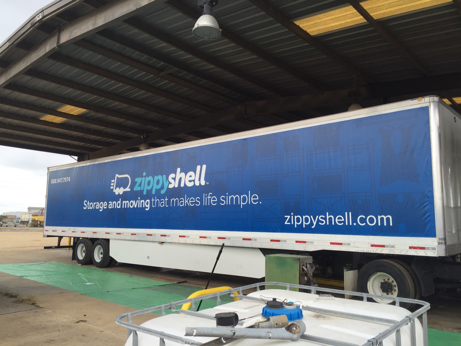

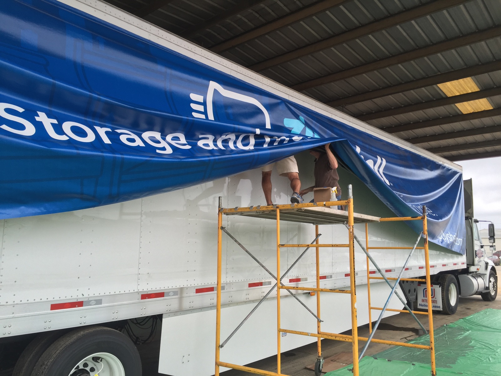

I have placed banners on the sides of tractor trailers with 3M dual lock velcro. We have done about 5 of these and they never came off. This would be the system I would suggest. You literally have to pound the banner into the velcro using a small mallet until it pops in. Assuming the surface they are mounted on is smooth
Did these roll down the road or was this just sitting still?
