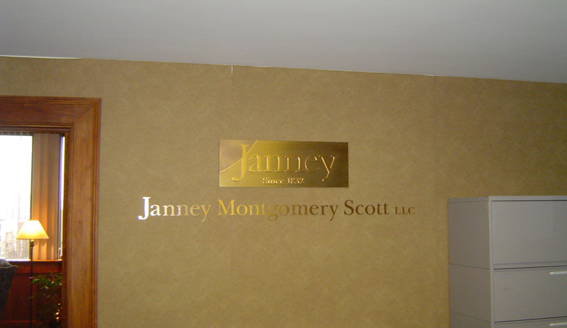

About two years ago, we started using a new adhesive sealant..... 75-AM Ultra Clear.
It holds anything in place and almost instantly. We hang 14" high solid PVC 1" thick letters with a few little dabs and it holds within 5 or so seconds. This past summer we did some... about 1/4" aluminum letters on an interior wallpapered room. We laid out all the letters on a piece of paper on top of foam. Pushed the letters to make an indent and used that for our pattern. Dusted the wall and placed the adhesive on the backs of letters with a little pig brush. Held it to the wall ad in a few seconds it held just fine. As a word was finished, Larry stood back and eyeballed it to make sure the kerning was dead on.
