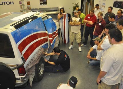

"Hands On School of Warp"
Mutoh is sponsoring the "Hands On School of Warp", a two day wrap training class for basic and intermediate levels, and an optional third day advanced class. I attended the class last week at the Sign Warehouse facility in Denison Texas. Justin Pate is a Master Installer and the instructor for the two day class, which was really worth every penny ($599). The class is only $499 for registered Mutoh users.
Justin Pate is the instructor on the Carwraps dot com videos and Real Wrap 101.
http://justinpate.net/
The "Hands On School of Warp" is going to different US cities, check out the website for a location near you. I strongly recommend you take the course, in the two day class we wrapped a van and box truck, Justin had a real good trick to use on all those rivet's.
http://www.mutohcarwraps.com/MutohSchoolofWrap.html
All attendees also receive one "free month" of video training from Carwraps® Video Training platform (MSRP $199/month), and Free copy of Speedwrap Xtra – Video of Justin Pate wrapping a vehicle in 2 hours.
I highly recommend you take this class before wrapping your first vehicle, as Justin address many common mistakes and also how to fix problems, like removing wrinkles.
