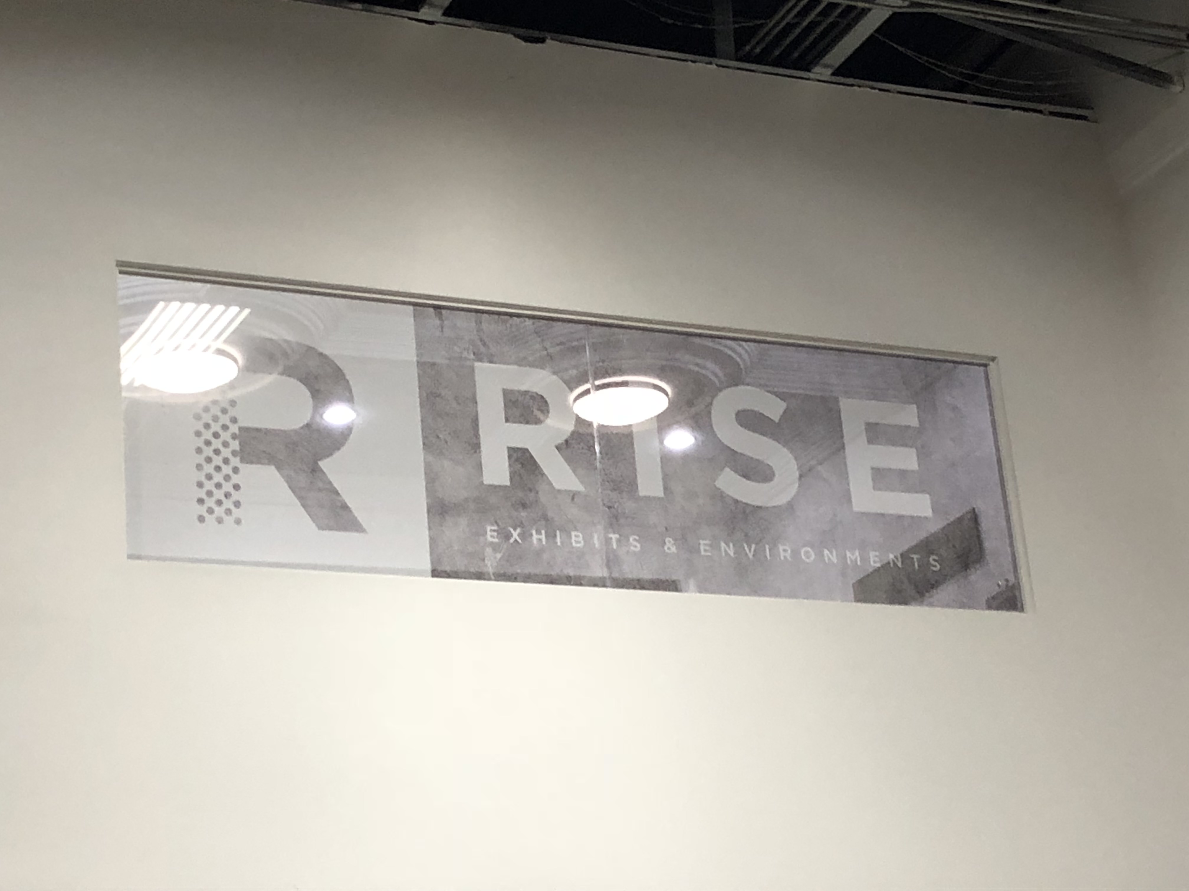

I'm looking for your suggestions on a great interior privacy window perf that is compatible with solvent printers. The boss' office overlooks the warehouse and he'd like to have the ability to look out, but not allow eyes in.
In the past, they used the Clear Focus ImageVue 65/35 Exterior perf on the exterior windows and tried using the same perf inside, but obviously that didn't work out. (See photo attached)

to my understanding and testing, the side with the most light is easy to see into regardless of the material being used.
think of the last movie / TV show you watched where there was an interrogation room. the observation room is the darker one and hence the privacy.

Just a tip: All one way window graphics rely on dark side/bright side to work. The side with more light see's more of the graphics and the side with less light can see through.

I learned the hard way. Some perf films are better for this than others. Our solution, though not as satisfactory as I would have liked, was to put really dark tint on the private side.

Just assumed that's how it was printed? Is it not like a rocky or grungy print? What does it look like with the lights off in that room?

I don't, unfortunately. It was done by the company's previous graphics guy and torn down almost immediately because of the finished appearance. It's not a rocky or grungy print, just meant to look "clear" in the areas it looks dirty. They were using a 65/35 perf, if that makes a difference?

i can see images / silhouettes of people in the "dirty spots". that's most likely the printed image on the perforated material ghosting-through, as result of the monster light source behind it.
The physics behind one-way vision materials is pretty straight-forward: it reflects glare from the bright-side to hide/distract vision of the dark-side.

Yup. I found the original file used and it included a concrete texture to it, which is where that "dirty" look comes from.
