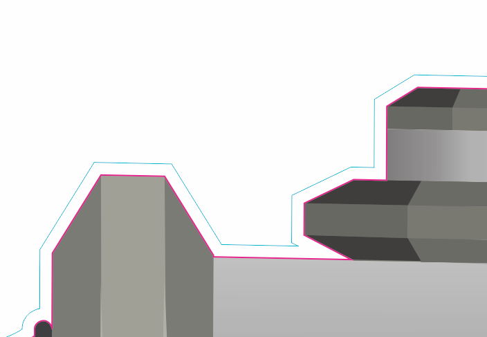

Super simple, just added a bleed on this in less than a minute. I used Adobe Illustrator vs. Corel like KMSP but same overall concept.
How did you do it? For complex artwork like this, I normally just copy the artwork to a separate "bleed" layer and then apply Offset Path to it. However, that method does not work on clipping masks, and this artwork is full of gradients in clipping masks.

select all layers and group, then go to 'object' + 'shaping' + 'bounday'
it would create a single outline based upon the shapes and nature of layers.
select that boundary and then select 'contour' tool and 'outisde' and then increase the size as much you need to give a bleed.
break apart then the contour and delete the 'bounday' and you would be left with 'contour' to be used as bleed on your over all design.
you can select 'cut contoor' (pink spot colour to cut in roland) and apply as outline to bleed.
centralise with 'grouped' design and that's it.
hope it helps
Not as simple as that. That's not a true bleed.
"Impossible"? No.
Time consuming? Yes!
But it can be done.
The design uses many different fountain fills. Using a single boundary around the shapes as a whole will not allow the needed gradients used.
In order to do it properly one would have to create contours on each individual shapes then fill those the same fountain fill as the orig shape then layered and segmented accordingly.

you can do a quick and dirty way with just the pen tool. It wont look nice to anyone looking at the file, or the print since it wont be an equal bleed.. but it'll work. Still a pain in the ass. And of course when you're bleeding 2 colors that intersect... if your cut is a bit off, it wont be that easy.
Personally I'd just offset the cut -.02 - .05" and be done with it... Unless you need it to be exact size, that should work ok with this design, and no one would be the wiser.
It'd be cool to find an addon that lets you add a .2" bleed by mirror the fill.. it'd come in handy sometimes, kind of like how in onyx you can add a 2" bleed and it just mirrors the image.... sadly I don't think anything like that exists.
So while your artist might have said it's impossible... Maybe he meant impossible within the time you want it done? Not that it'd take that long... but someone who isn't familair with adding bleed to multi colored objects like this might spend days doing it perfectly, not realizing spending 10 minutes making a mess out of pen tool would produce the same result.
