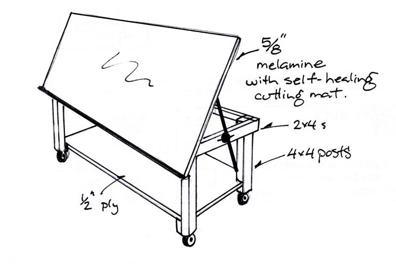

Me: I have a 30" x 12' long (flat) countertop table (against a wall) for all weeding & tape application, and right behind me is a 4x8 easel which is hinged so it can go down flat when required. It's built on a 2x4 frame with 4" x 4" posts on the corners, and is on wheels, so can be moved around.

Colin, that would be slick just for getting 4 x 8 sheets onto the table. Set them in place then tip. I'm not getting any younger. I might have to build one of those.

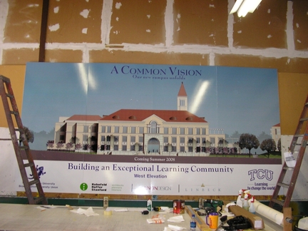

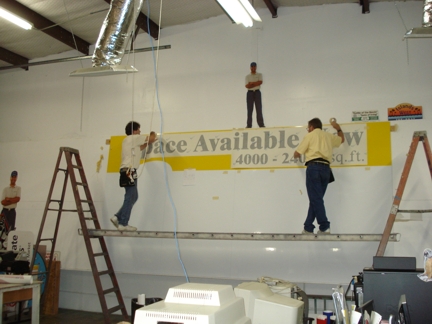

As Emo said our easel is 8 x 32'. It is very handy for doing multiple copies of 4'x8' panels also. Line them up across the easel, Someone preps, two measure/tack in place and someone places the vinyl. Rinse and repeat.
After 24 years we finally painted the back wall.
And you see the big table holds my coffee cup just fine. :Coffee:
