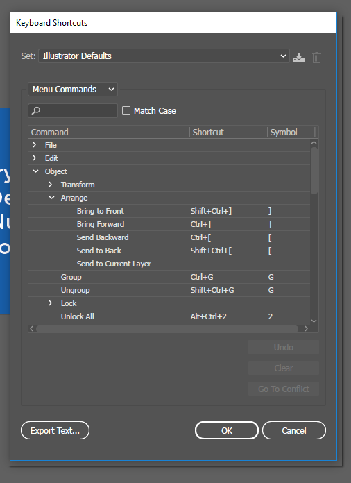

not true. see below
Yes, for instance navigate to change the shortcut for Object/Bring Forward. The default is Ctrl+]. Try to change to Ctrl+PgDn which makes a lot more sense imo. Can't do it.

not true. see below
Certainly looks like you can...
myront
Dammit, make it faster!!
Looks can be deceiving. Go ahead, try it. It will tell you "can't use that one"
WildWestDesigns
On CS6, it won't allow you to use PgDn either on it's own button or with num lock off on the keybad PgDn. That may have changed in CC versions.
Might be able to change it to something else, but not that specific one in that specific fashion.
My workaround would be to use Ctrl+3, which is where the num pad of PgDn is located, just keeping num lock on. I can't think of anything else that would need to use the shortcut Ctrl+3, so to me, that would be close enough.
