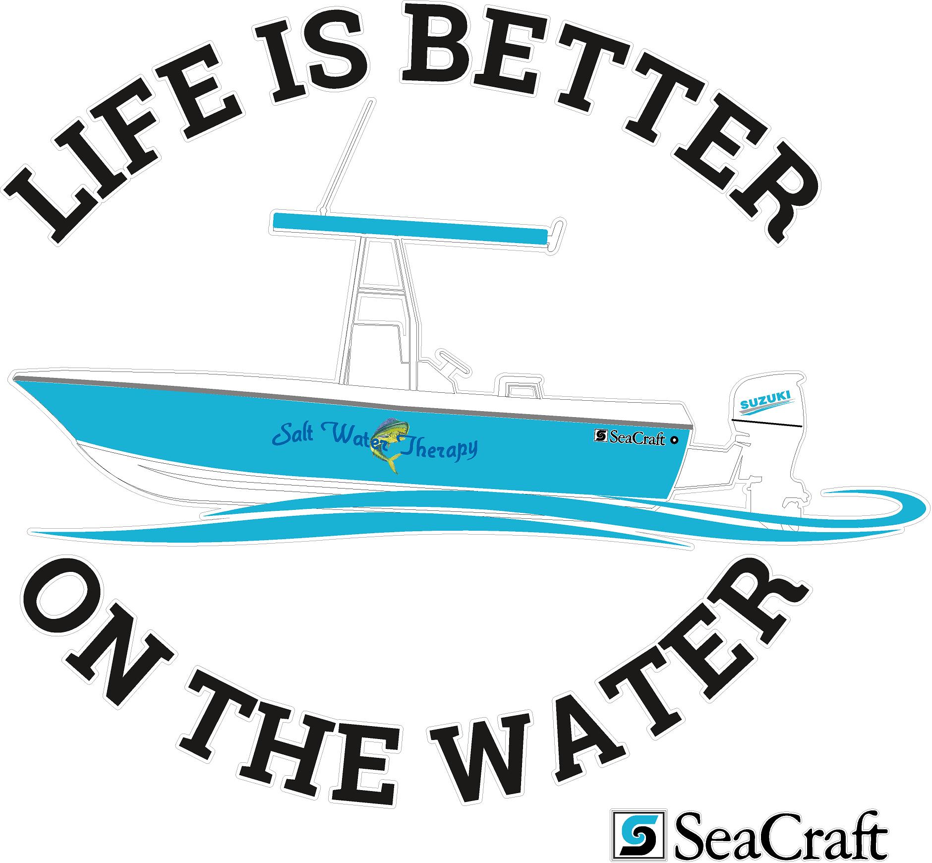

  1. I created the attached file in flexi using the drawing tool etc.

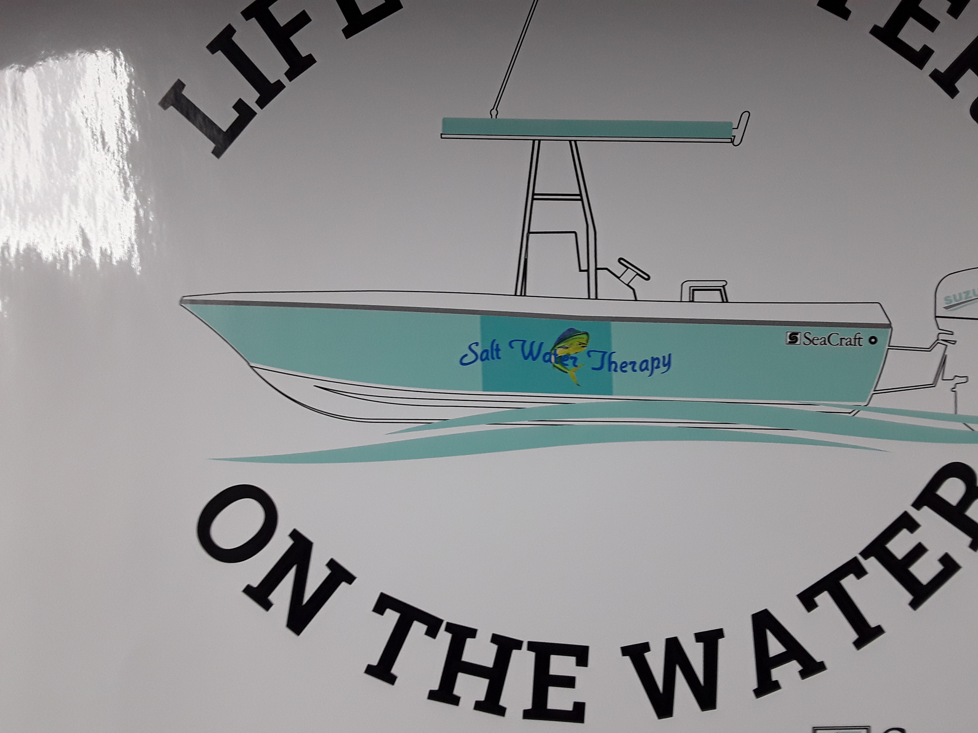

    It looks perfect on the screen but when I rip it to my HP315 the area around the logo looks as if it double prints the hull color. What am I doing wrong?

    The logo has a mask on it, rasterize and re-insert.
    • Like Like x 1
  3. That did it! Thanks a ton!
