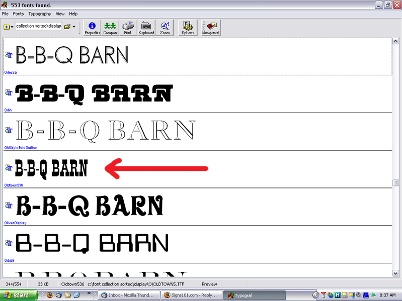

I did the following:
  • Years ago I sorted and organized my fonts into categories and stored them all on a network hard drive
  • I looked at the font to see if I recognized it, allowing for the modifications such as stretching, slanting, condensing, etc. and concluded that it was probably PT Barnum, Lamplighter, Old Town, Playbill or something similar that would be in my Headline and Display font group.
  • Launched Typograf, entered the text "B-B-Q BARN" and navigated to the Headline and Display folder to scroll thru those fonts.
  • On reaching Old Town, I noted that all earmarks appeared to match and that the font would need to be stretched. Right clicked Old Town to install it.
  • Copied TVG's sample to the clipboard, launched Photoshop, opened a new window and pasted the original into it. Enlarged canvas to accomodate additional comparison typesetting.
  • Entered the text and tweaked the height to match original then tweaked the stretching until it also matched. Took reading from palette of 205%,
  • Flattened the image, saved as JPG and posted results.
Elapsed time was less than ten minutes.
The other way I could have done this would have been to start in Photoshop and condense the sample by different amounts until doing an automated comparison in FontExpert gave me the correct result. In this case, it would have probably taken slightly longer to do it that way.
