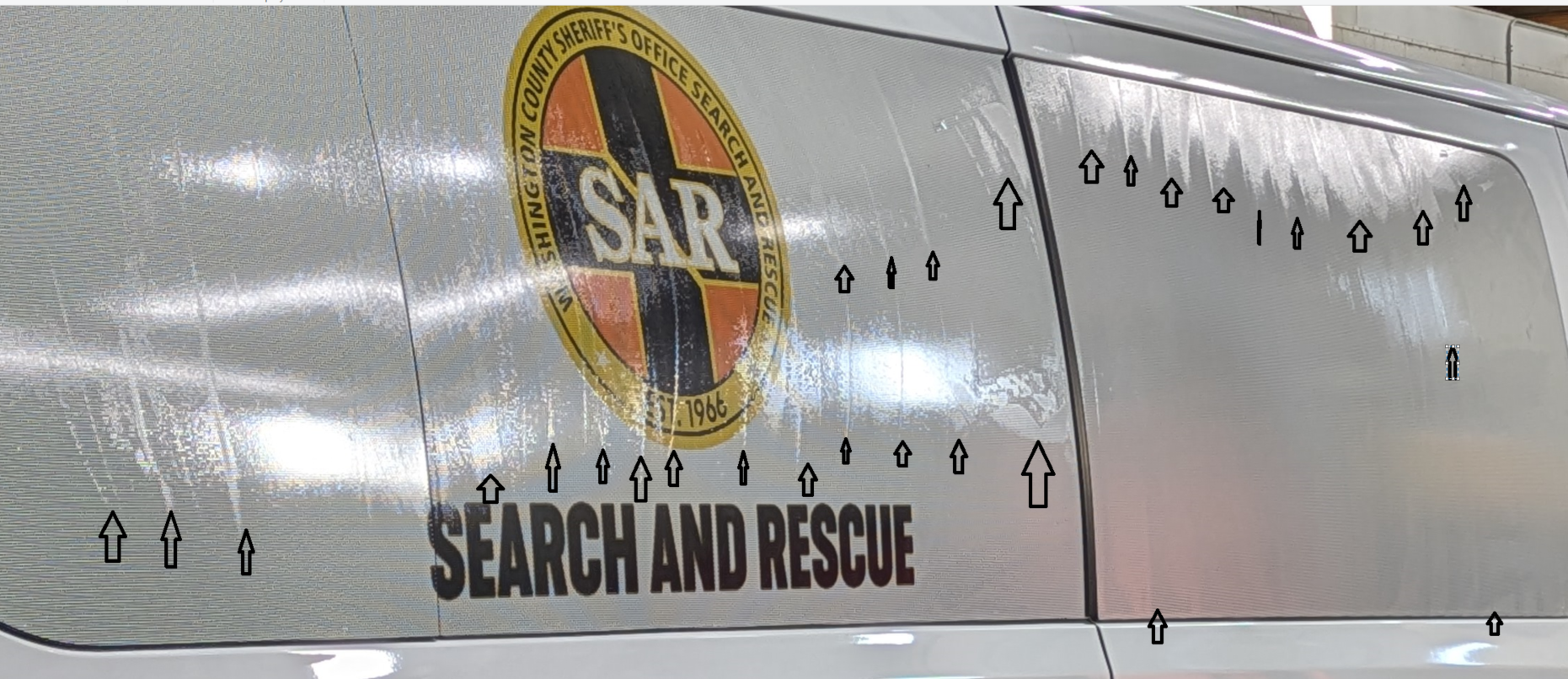

Has anyone come across this issue with "streaking" marks staying on laminated window perf? I am used to some of these staying (even with very light install touch) but will come up over time however its been a week and client says most are still apparent. Any advice on how to remove, fix, or avoid in future please let me know.
Media: Fellers 50/50 dual
Laminate: Avery 1360z
Printer: Colorado M3 with perf profile.

this is why i hate sheet laminating perf, especially on a contour.
even with the slightest touch, you're still conforming a pattern of holes with a piece of clear bridging over it, and its gonna lay slightly stretched wherever your squeegee/hand-tension is applying it.
managed to limit this on flat windows, by setting a horizontal hinge and hoping to just let it "lay-down" from top to bottom & assisted with some transfer mask to keep it as rigid as possible during application.

yes.. We've used it once on window perf and it came out like the picture above. In fact, I thought the picture above was with liquid lam.
The customer was not at all pleased and worried that the streaks wouldn't go away, so we reprinted it. and now we dont laminate any window perf.

On this perf in particular, I'd have the customer park it in the sun for a couple of days before redoing it. I understand its been a week already, but are they parking it indoors when not in use?

We do laminated window graphics all the time. Have never had that happen. Perhaps your installer is stretching the material and/or squeegeeing too hard--perhaps with a chiseling technique? Any places where we see that immediately after installation, it goes away on its own with exposure to heat and cold outside. It generally comes from making the laminate stick to the window through the holes of the perf.

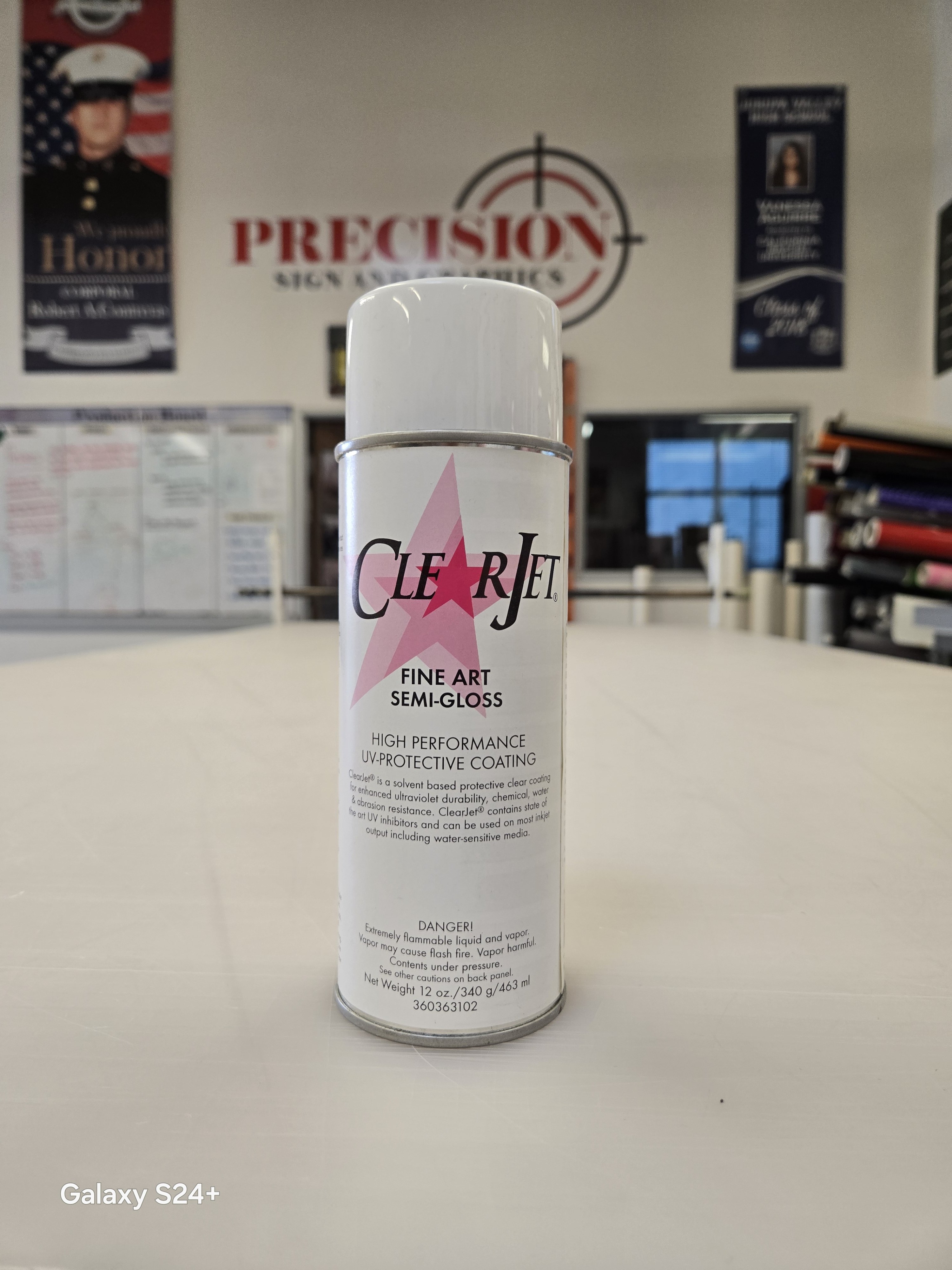

Perf is a one to two year product. Our printers uses a 3 year ink product. Lam? What? Why?
If you really feel that you need to lam try using ClearJet Hi Performance Protective Coating. Comes in an aeresol spray can, costs about $12 a can. One can will do a pretty good size window job or more.
