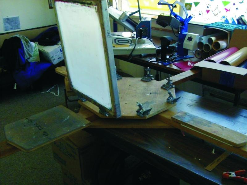

heres my homemade press, i used a barstool swivel for the base. I also use calendared vinyl for small runs...up to 48 pieces with vinyl. i mirror,reverse weed and stick it to the shirt side of the screen and saves from having to burn and reclaim. saves alot of time and this little press makes me good money.
Thanks for sharing Flame.

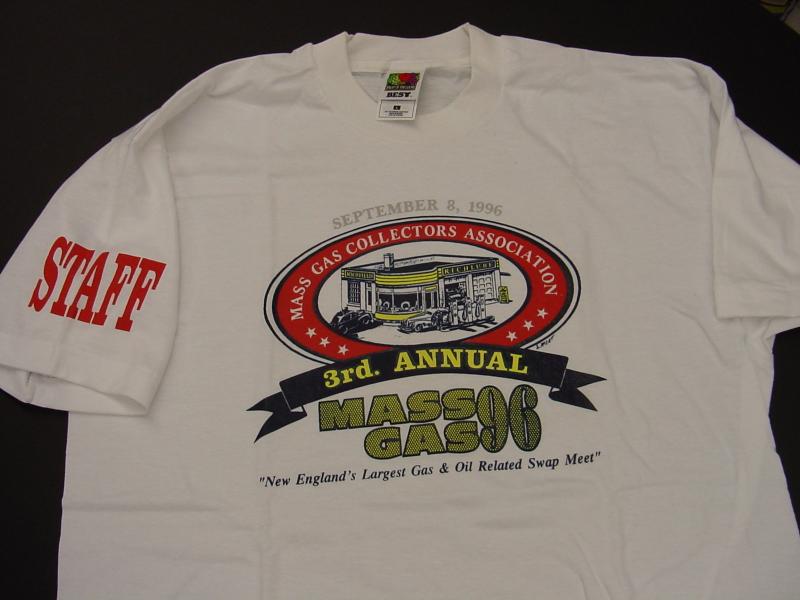

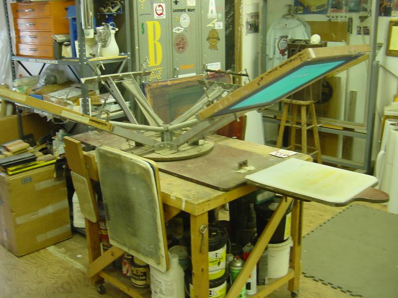

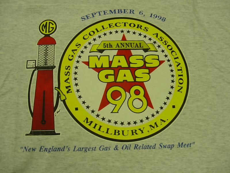

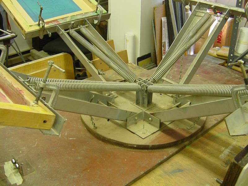

I built my own four color rotary manual printer over forty years ago, still works perfectly today. Also pictured are two shirts printed on this unit.
