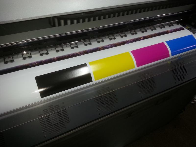

Tried C M Y K test with colour correction off(which previously was horrible)
AWSOME

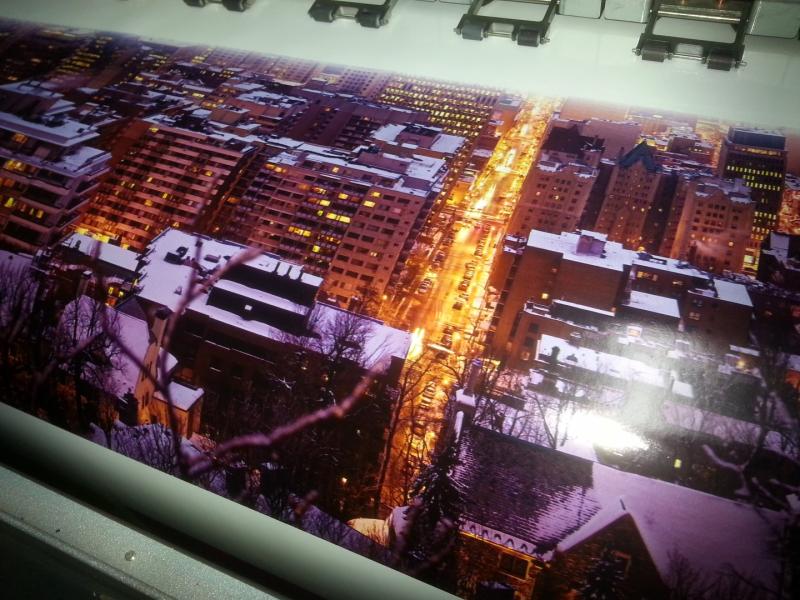

I have put this list together to try and help others.I bought this printer 4 months ago and i didnt have a clue how they work. I was probably thrown in at the deep end as the Mimaki seems to be pretty high maintenance, but saying that...the print quality for a machine that cost me under $3000 is awsome. I hope this list helps others with some of the problems they are having with there printer.
Ive included a couple of pics of the printer in action.

Printed previous file i was having bad issues with
PERFECT
AWSOME
