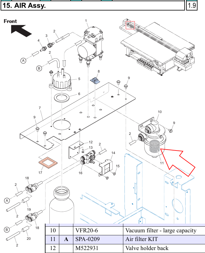

Check the filter near the throttle valves, these can clog and cause issues.

Filter tends to be low hanging fruit, good to keep those on hand anyways. But it could be the solenoid valves, or the throttle valve itself. Also seen silly things like loose subtank connections causing it. Anything in the system is suspect, but it surprises me how few people know the vacuum filter is a thing that needs regular changing.
