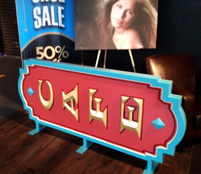

Not installed yet but ready to go up. This is a double face projecting wall sign. Measures 30"w. X 72"h.

Thank you all. I enjoyed putting this together. Aluminum, PVC, HDU, PolyMetal and lets not forget....Matthews Paint!

Deceptively complicated in fabrication, but the result is clean, simple, and classy.

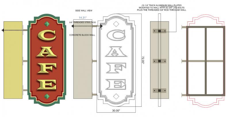

Jill you nailed it with that description :thumb:
Here's a detail to give a better idea what went into the process.
