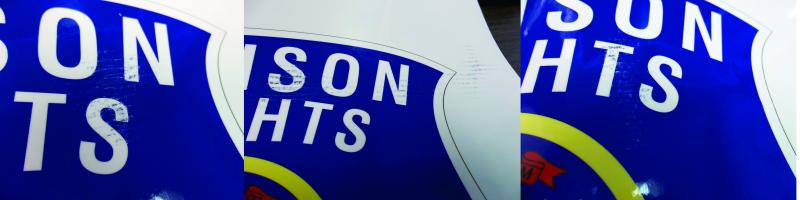

I don't know what the issue is because the media is perfectly smooth when it starts out, nut then it goes under the rollers and where there is a space between the rollers, it raises slightly and the print heads stutter (best word I can think of at the moment) over the surface and leave nasty black marks in rows down the image.
This is happening more and more often, no matter what media I use. Even vinyl. So... are my rollers too tight to the print material?

take a good photo of the effect. also are your pinch rollers clean? they can get gummed and leave tracks.

The best I could do. Hope it's visible.

What's your heat set at? Did you remove the High/Low toggle on the head carriage?
Edit: Also, check under the heads to make sure there are no ink-stalactites. You might have enough clearance for a clean head, but not one with ink deposits around the sides.

Yeah the thick/thin toggle is what I meant. Just wondering because without it, it's possible to set the carriage too low.
If it were just one media raising, I'd say it's your media. Your heat's nowhere near high enough to cause warping in all of your media as well.
You might have a busted vacuum unit. It's set to high? Do you hear it whirring up when you load media?
