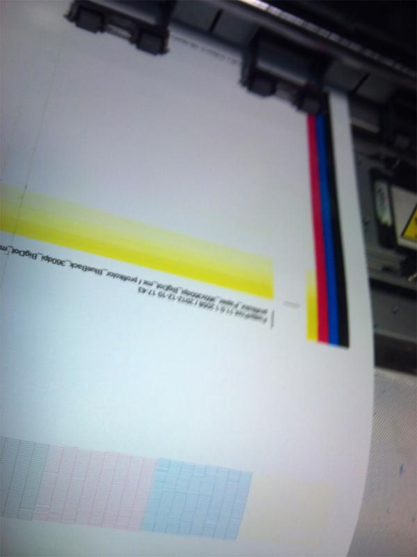

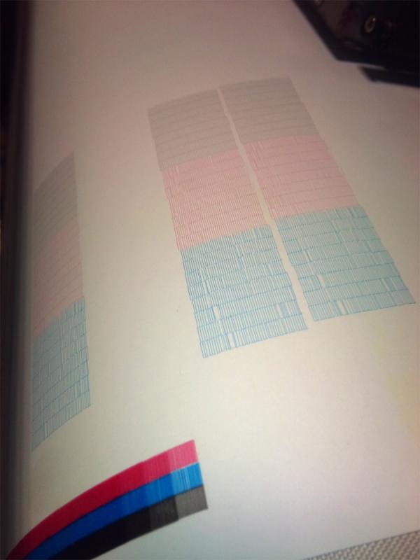

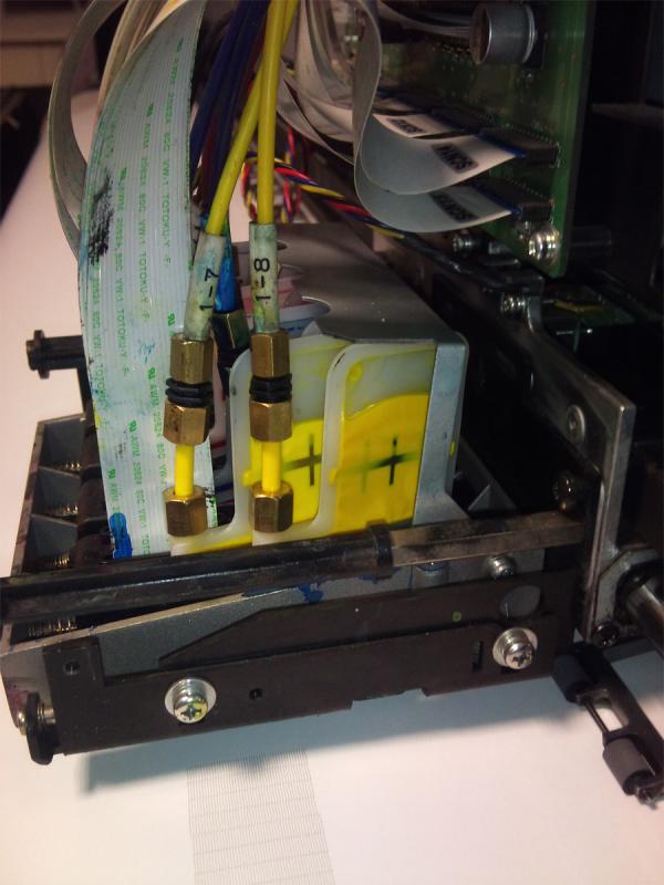

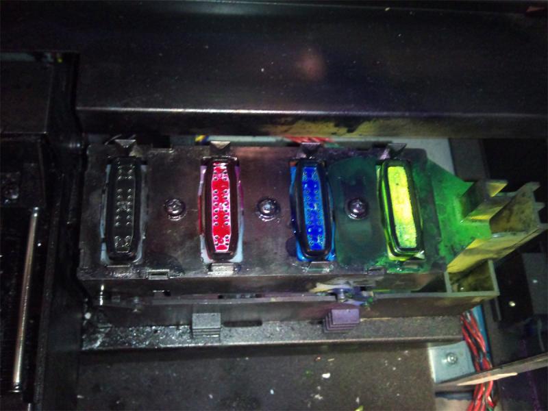

    I have a problem with yellow print head Mimaki jv-3 sp. On Friday replaced the black print head, all new dumpers and cap tops. Print were good. Today, missing yellow. I used a syringe pump behind. Sucked the color from dumpers. Dumper is full, I cant seen air in the line. After that test print looks good but when printed yellow disappeared after a while. I did replace the cable on the print heads (data swap - cyan, yello) Test plint was - cyan. blak, magenta - looks good, no yello. Can you ask for suggestions? I have no idea already. Thank you for your help.
    Regards
    Mario
