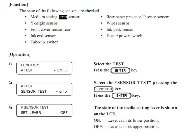

i think i kind of fixed it. i found the sensor test in the maintenance manual.
the first test is "set lever". you can set it "on/enter" or scroll down to "off/enter".
basically this acts as the firmware override. i searched for this like nuts when i first got the printer. gave up. and hacked the sensor away from the lever.
but, now with the lever set as "on", it will boot and measure regardless of the lever position! not sure if the lever sensor is bad or good. and don't care. the printer works.
