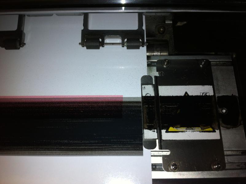

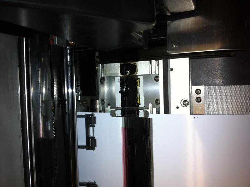

    After a few incidents of Ycurrent errors, i thoroughly cleaned and oiled the bar. Then went to hit print and this happens?? A coincidence? A bad head? I swithched data cables to magenta and it still prints solid black like in the pic?
    And it prints all over the platen to.
    A tech is days way!!! What to do??

    encoder strip and/or sensor
    check the clear strip that is behind the printhead carriage for dirt/oil/etc and clean with only isopropyl/water
    check the encoder sensor for the same, bit more difficult as it requires removal of hardware from the printhead carriage.

    encoder strip was my first thought as well. carefully wipe it

    if you did a data swap and the issue stayed at the black head. then you may do one more thing. this issue will happen if a data cable isn't seated properly or damaged. after getting a positive/negative on the data cable. also completely swap data cables (both ends) trading the magenta cable for the black cable. this will isolate the cable itself. if this doesn't give you some other feedback, then i'd say that the head is dead from dripping something on it or zapping it in some way.
