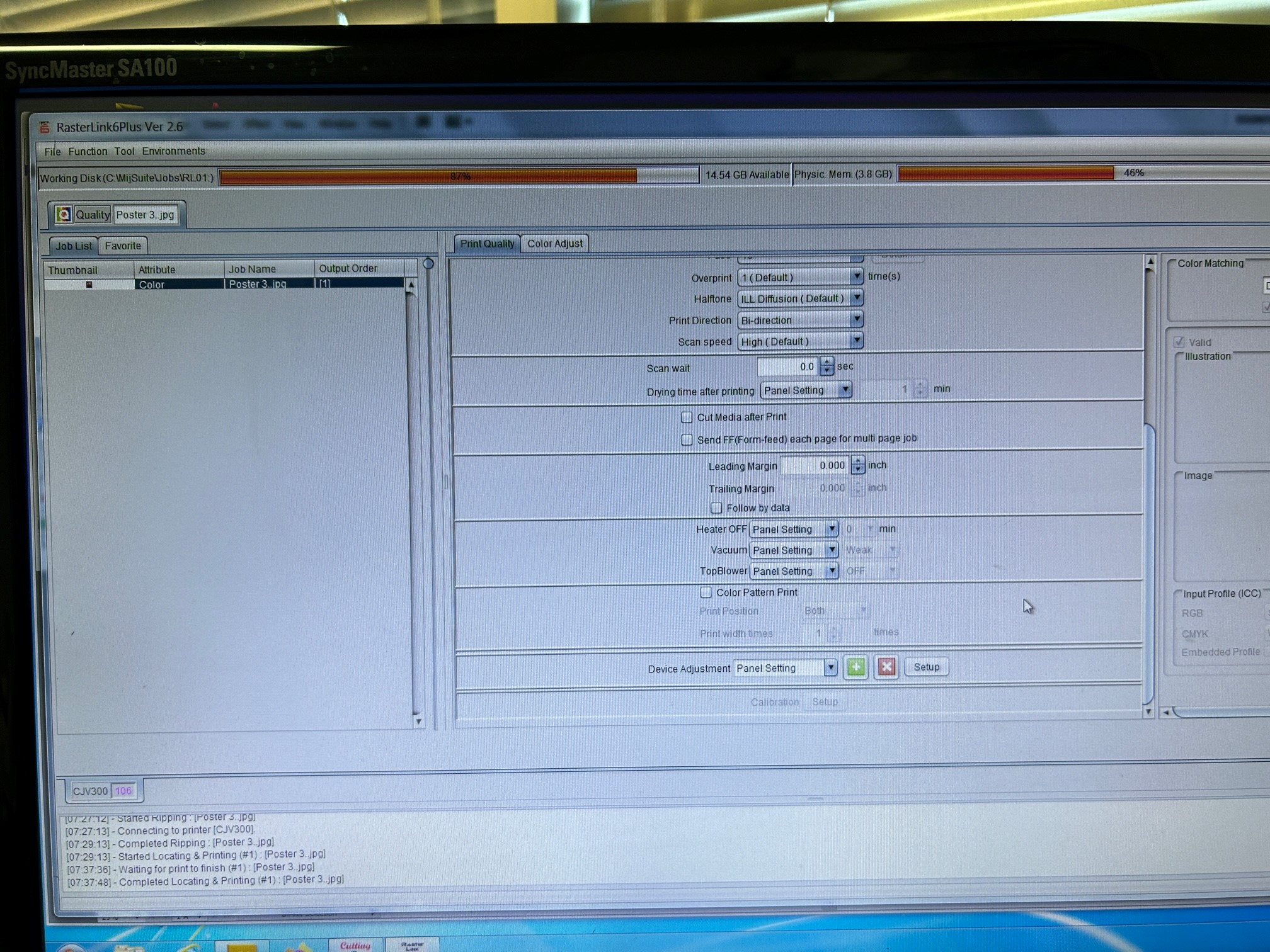

Rasterlink is now showing this option.
Is there a fix for this?
I meant to include that I am looking for the option to disable either head 1 or head 2 in Rasterlinkpro6 version 2.17 / 6.1
My printer is a Mimaki CJV300-160.
