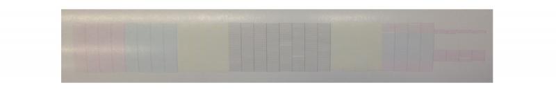

    Printed about 1000 green labels this morning totalling about 20 yards by 48", when getting close to the end of the print the green was getting extremely light. so i did a few cleans , ink fills , nozzle wash, called the tech line, I was told its probably the pump, anything I can try, to maybe get it to print till they can actually get here next week
    Im getting half my magenta, the other half well, its disapeared
    heres a print test
    ideas ?

    do a 99 minute head soak and then a strong clean after that do a test print

    and after that if its the same, would the pump be the definate problem

    same thing, nothing changed

    Cannot say it's definitley the pump. Could be the pump, the capping top, the damper on that particular channel, a leaking o-ring on the ink line for that channel, head manifold, etc as well.
    I'd try swapping those 2 ink lines and dampers. Then do some more testing to see if the problem follows the ink line and damper next.

    ok did another 99 min soak yesterday and a ink fill same nothing changed, forgot to take a pic of the head, so this morning decided to clean my cap to the extreme, so while doing this the head was off the cap it left big globs of mangenta on the vinyl, now im doing another 99 min soak will take a pic after this.
    for switching the lines do I do that at the head, do I swicth the lines and the dampers or do i try both?

    Probably not going to be enough ink line to swap the lines themselves since the magenta dampers are on opposite ends of the head so you would have to unscrew the ine from the damper and try swapping just the dampers. Carefully have to remove the 2 metal damper retainers first.... but if this is an area you are not comfortable with you will probably need a tech out. Do NOT press on the flat sides of the dampers at all, only grab them from the edges or you will open the valve in it and get ink all over the place. This is a fiddly thing to do and you do not want ink on the top of the head board but the manifold should prevent this. Still have some paper towels handy....

    ok I tried that, now the opposite side of the magenta is not there, does this mean the damper is shot?

    ok what the hell, haha, they are back on both sides now

    wait a minute Im starting to loose the left one, but the right is perfect

    The ink line on that damper was probably just not quite tight enough then and it was sucking air. Switching the dampers/lines required reseating those ink lines which fixed it. That being said, if the left channel is now going then I'd guess that damper is probably getting worn out or clogged internally. Only other ink line unioun I can think of would be at the joints behind the cartrdige slots. You can pull that back cover easy and see where the lines split to go to each of the individual dampers. It's possible the o-ring in the joint there might not be tight.
    Little bit of hair pulling and frustration with a bit of one steap at a time troubleshooting and you just saved yourself a several hundred dollar service call from a tech. Nice work! :)
