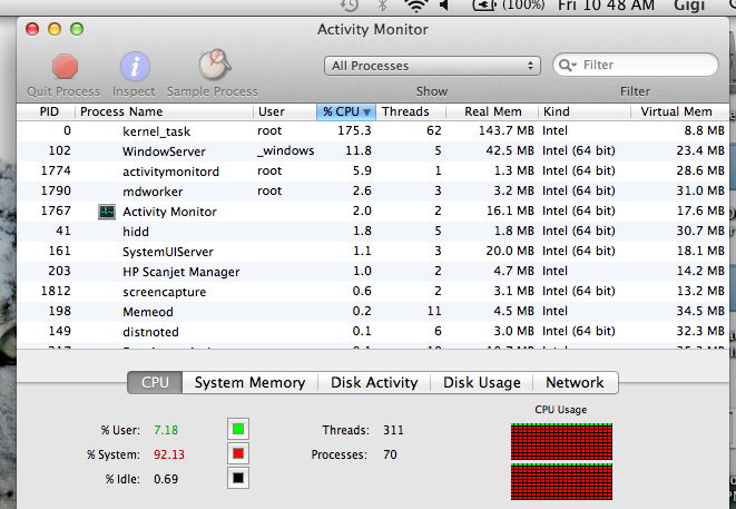

    Can any MAC users offer advice on "Kernel Tasking" ...i'm sooooo not a hardware person. I have a first generation MacBook Air and have never had a single problem with it in 4 years... until the past couple of months. This issue started after a FireFox update, but that might just be coincidental, because the problem seems to occur no matter what browser i use.
    What happens is, my system gets bogged down, starts running like it's been dropped in quicksand and then starts to heat up. I know the bogging down isn't a result of overheated, because the temp doesn't rise till AFTER the bog-down.
    Ever time this happens, checking the activity monitor, i can see the problem is Kernel_Task! I can watch it go from taking up 5% of my CPU to.... GET THIS... 175% of the CPU!!!! 175% how is that even possible?
    All the information i've found has been too techie for me. While i'd like dumbed- down answer to:
    do i even need Kernel Task?
    if not, can i somehow trash it?
    is it causing damage to my system? (or just my temperment)
    and 175% what's up with that? (some kinda fuzzy math)
    But all i really need to know is, HOW DO I MAKE IT STOP?
    this screen shot may not tell you anymore than what i've already mentioned, but just in case, here it is.

    -The kernel is basically the brain of any OS, so you do need it.
    -No, you can't trash it.
    -If it gets too hot it could damage your hardware.
    -Not sure about the 175% part.
    Googled around a bit and this seems to be a pretty common problem, couldn't find any clear cut causes or fixes though.

    Not a Mac guy, but I'll throw my computer nerd hat into the ring.
    Most common cause for something like that would be one of two things:
    a. Malware designed to eat up primary system resources.
    b. Heat-syncs have become detached from the CPU, and need re-seating/re-pasting.
    Had the latter happen to me just last month. Laptop got crazy hot doing the simplest of things, and the whole system would grind to a halt. Opened it up, and sure enough, a bloody screw had come loose somehow, and the heat-sync for the CPU wasn't making solid contact anymore.

    the answer is in this link http://tech.superhappykittymeow.com/?p=258
    all ya have to do is search "first genereration macbook air kernel task problem" and you will get about 47k entries and many forum responses with solutions if you can understand them,it seems this is a common issue with that particular model ,no snide comments about toilet habits here tho,....

    if anyone else has this problem, i thought i'd mention, the one from round man's link, that i'm testing right now,
    the step by step posted by chuck, but stoping at step #3 as suggest in franks comment.
    removing: IOPlatformPluginFamily.kext
    so here i am, 2 hours later and so far so good!!!!! :popcorn:

    175% of cpu is because there are multiple cpus (well, multiple cores). Just like you can have 400% ink coverage on a 4-color printer.

    oooomg...:clapping:... it stopped!
    what finally made this an easy fix is one guy's input that simply said...
    find ____ on your system and delete it.
