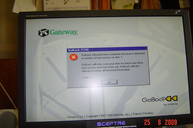

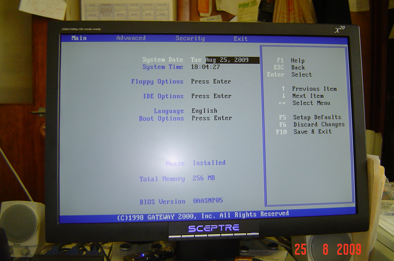

    These are the two screens I keep getting. The 'Num Lock' goes on as soon as it starts to boot and the keyboard and mouse are useless. That's why I think everything is fine.... if I could only get there. :frustrated:
    :help

    I just re-read your screen and it says something about bad sectors in disk one, so the problem is quite possibly with your hard drive being corrupted as opposed to you having a bad motherboard... its time to call the computer fix it guys... they may be able to take it apart and put different pieces into a working computer and find out which of your components is causing the problem...

    I've had those bad spots for about two years now. I forget what they represent, but I don't think it was anything important..... I hope. :banghead:

    414
    Oct 28, 2008
    here is what my ex, who is a computer tech guy for the last 8 years says:
    "it sounds more likely to me that if you have bad sectors and the keyboard and mouse don't work that the motherboard is starting to go bad or the power supply or something and it's making it look like the HD has bad sectors and the keyboard and mouse is bad"
    so take that conjecture with a grain of salt :)

    Gino is the computer beeping at all during start up?
    Also how did you get into the Bios if the keyboard doesn't respond?

    Given that you posted a picture of your computer entering into BIOS, it must then be assumed that at least before the OS begins to boot, the keyboard IS being recognized otherwise it would be impossible to access into your BIOS.
    This means that it is within the operating system itself that the keyboard and mouse are not being recognized. So, if you are getting the message popping up that you are having bad sectors recognized in your system, and the computer suddenly becomes unresponsive (making it appear that the keyboard and mouse are no longer working) it is either that
    1) you are using a USB mouse/keyboard that is not recognized in Win98, or
    2) you DO have bad sectors in your hard drive, which means hard drive failure. This can especially cause your system to become unresponsive (again, appears the keyboard and mouse no longer are recognized) if the bad sectors are areas where the OS files could be located, making the system crash during the boot of the OS.
    My suggestion, get a computer tech in to see if they can do a chkdisk or a better utility to search and fix bad sectors. If it's something those utilities can't fix and restore the data....it's pretty well dead. Move it and put the hard drive in any computer you want, the OS and hard drive would still be corrupted.
