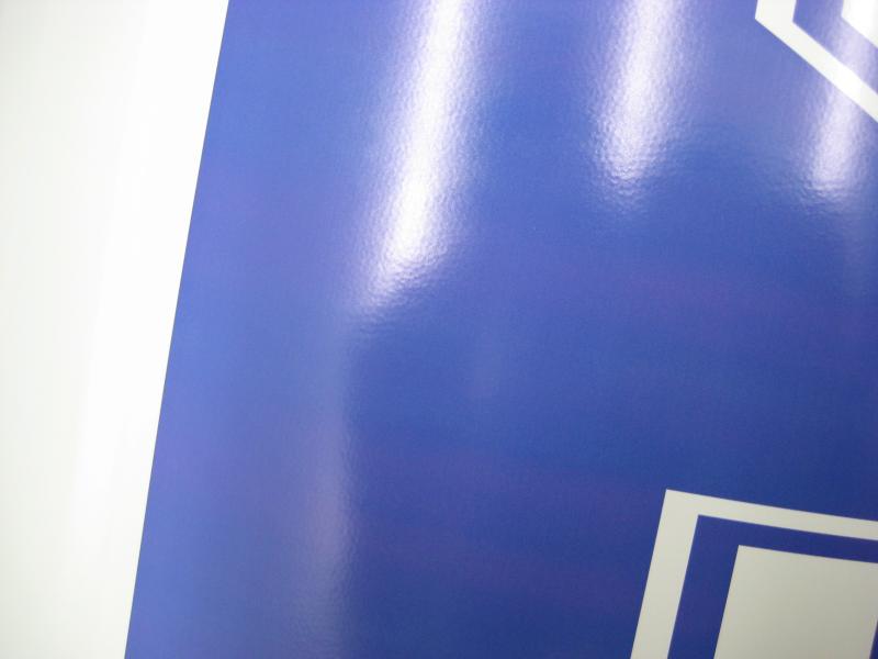

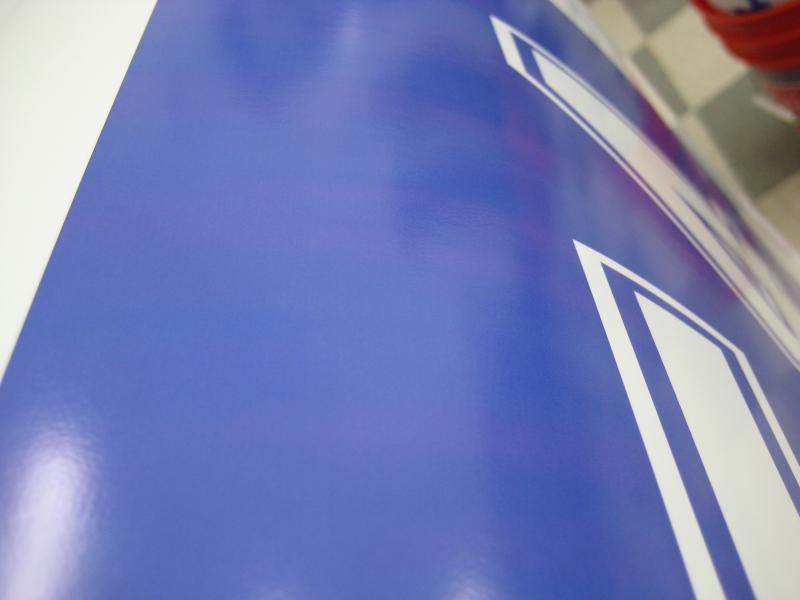

here are some pics of what it is doing. i have a call in to mutoh now. we will see what happens.

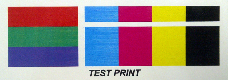

Here is my Test Print. It shows Magenta, Yellow, and Black looking solid......but Cyan is all streaky......any Ideas??
Do I need a new head? Can I remove the head and soak it? Please help!
