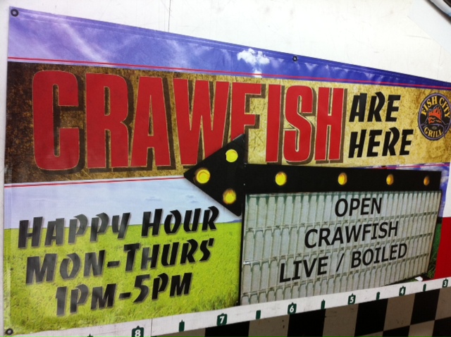

Ya'll should try 13oz zeelon from Fellers. It prints way much better then ultraflex and will stay flat after the prints, not like most banner will become wavey, zeelon doesnt. Only the matte zeelon works though.
