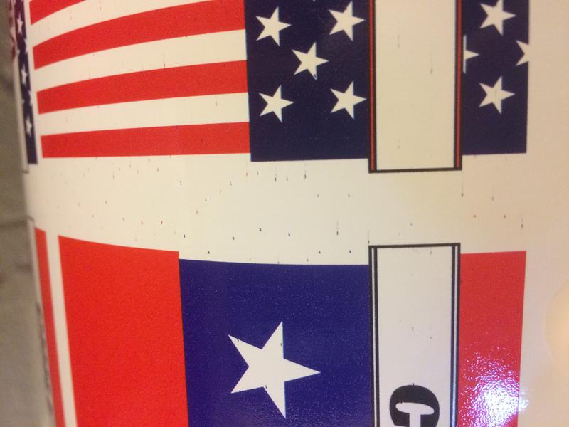

Hello everyone. I wonder if someone knows a solution on how to fix this.
I tried to do a printhead clean, and then did a test print, everything seemed fine after I did that. Started printing again, and it happened again.
It was kind of late last night so I just cancelled the print.
Is there anything more I could do before I start printing again. (except printhead clean in the command menu)
Thanks

Depending on how much ink you've run through the printheads, may be time for a change. If you can isolate it to a particular color, then perhaps only change that set of heads. If you start seeing banding, dropout, and misfirings or clogged nozzles and you've run more then 5000mL through the heads of this machine, then just swap in new ones. Dropout like this on the L25500's is often a sign of heads starting to fail -- could be because of a media jam or something similar too.
You could also do a manual printhead cleaning though you need to be gentle. I used to use isopropyl alcohol swabs and gently wipe down the bottom of the printhead in one direction. Gently shake and return to the printer. See what this does for you.

Thanks for the response. All of the heads but one are no more than 1500 ml. 3 of them almost brand new. One is a bit over 4000 but that one has a pretty damn good test print for that much of printing.
I believe that there must be something stuck on the bottom of the printhead. and it is dragging on the print. It has speckles of the ink in all colors and all over the print, that would eliminate issue with one only one printhead.
Is there a way to pull out the cleaning cartridge to check the bottom of the printheads? Or I will need to pull one by one to check them?

I guess there are multiple ways to do it, but it depends if the machine is on or not. If it's off, then what I would do is manually move the printhead cleaning cartridge to the front, then remove. Shine a flashlight in there and see if anything is visible. You probably won't be able to reach it well, but this is an easy way to visually inspect the bottom of the printheads. Stick your phone in there if you want and snap some good close-up pics.
Alternatively, if the machine is on, you can initiate a printhead replacement, then remove each one and visually inspect and if there are issues, then use the alcohol swab to gently wipe clean. Replace any and all printheads and let it complete the printhead alignment test that follows.
If something is stuck to the bottom of your head, then you should have no problem cleaning it up and returning it to a normal state. I noticed this alot on the 25500, but ink would begin to dry and cake up around the edges of the printheads and that can sometimes cause deflection, or if one of the dried crusty pieces comes loose it can cause the issue you're seeing.
Personally, i would initiate the replacement with the machine on and inspect each head, and scrape the caked on gunk off if any, and gently wipe the head with an alcohol swab only IF there are any visible issues.

nothing to do with printheads, you have some ink build up somewhere under the carriage, investigate more closely and report back....

How to get there? :)
I purchased this printer used and do not know much about taking it apart. Taking the cleaning cartridge out and then checking under it?

there's a hair
Looks to me like there is a hair or string stuck in your print head undercarriage.
Have operated the larger model of this HP, the 28500, and haven't seen any dripping problem like this that wasn't some kind of string collecting over spray ink and dripping it onto the material.
It doesn't look to me like a print head failure.
It's in there. Keep looking.

I found the issue. I went in and I pulled out the cleaning cartridge. Cleaned the printheads and a bit around them.
It looked pretty good and I could not see an issue there.
Started printing again and I noticed that it prints good.................... until the substrate jam reflector did not get to above the print.
It looks like there is something attached to the bottom of the
substrate jam reflector and I just did not have a chance to clean that area again.
Should do that today afternoon and I will let you know if that is the case as soon as I'm done.

I tried cleaning under the front of the printhead carriage. No luck.
Does anyone know how to get under there??? I get the cleaning cartridge out, but that part is still over the funnel and can not be cleaned from there.
When I push the carriage over the platen, it is too tight under there.

Assuming you don't see anything stuck, I would consider taping some felt or other soft material to the platen and manually running the suspect area of the carriage over it to see if anything rubs off. Avoid the print heads, of course.
I have had stuff get stuck under the carriage, but removing the cleaning cartridge has allowed for enough access to deal with it.

Fixed last Saturday. There was a "hair" hanging on the carriage (As previously mentioned by Doug).
What confused me, it is that it was on the trailing end (Back) of the carriage. For some reason, I only tried cleaning the front :)
All good now. Thanks everyone for you time and info.
