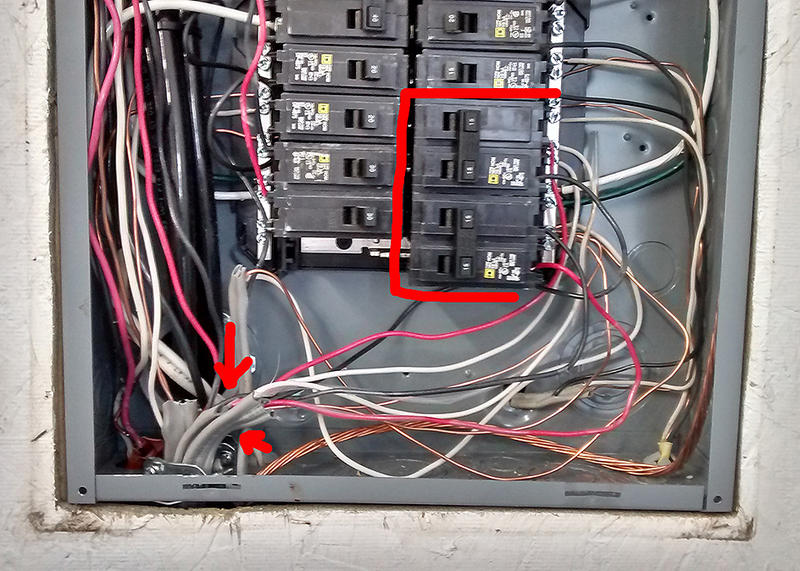

Yep I did that first before I opened the back of the printer. I have exactly 120 volts on each side of the plug (not on the ground of course) for each plug. Yes your right, the right hand plug goes to the heater circuit, but that circuit also takes power from the main PSU on the left. We also tested the pins on the plugs of the main PSU and they're all 0 volts. Some should be 3, 5, 12, and 48 volts. Which is what made me believe the PSU was DOA.
MrTopgun21
fire your electrician, its hooked up wrong
take your breaker panel off and post a picture
Here's my breaker, the two doubles are hooked to the plugs on the wall.
