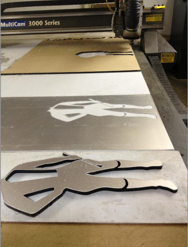

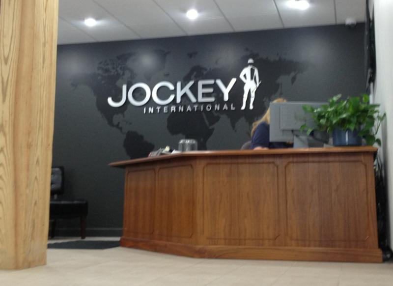

I have done this with Sintra and 040 brushed alum to put on a router. Get some 6" Banner Tape and apply it to your acrylic cut to desired size. Get your brushed alum and cut it to size. peel the banner tape backing. Then get some 1" pvc and lay them vertically across your sheet of acrylic. depending on the size of material determines how many you will need. You want to keep the 040 from touching the acrylic/banner tape. Keep your ends in about 8". Line up Alum then staring on one side, start tacking the alum to acrylic, then pull out each pvc one at a time push the material down from the center out. Once you get to the end run it through you laminator.

contact cement
