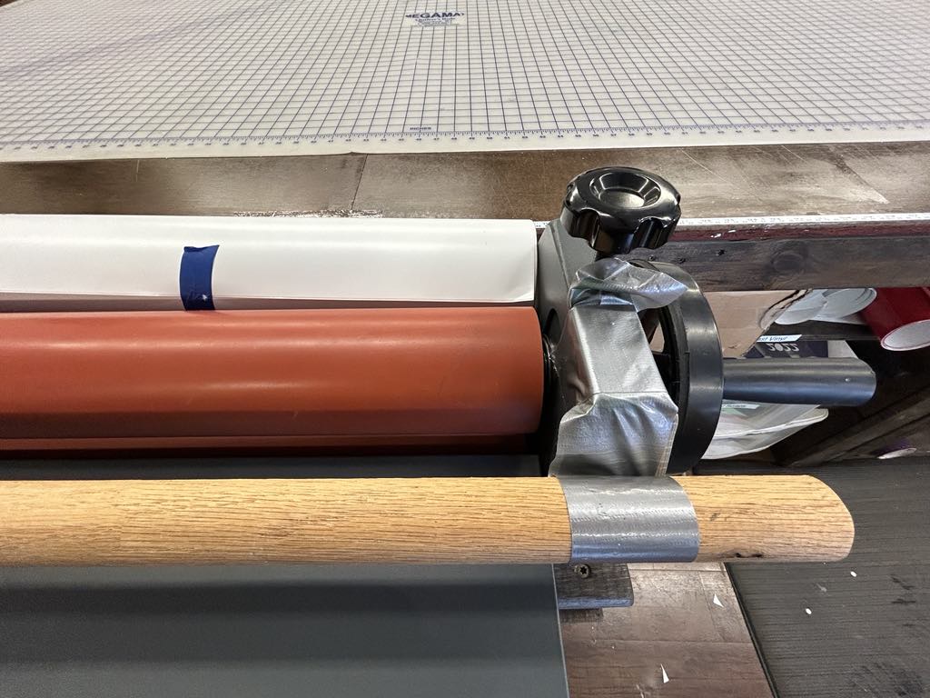

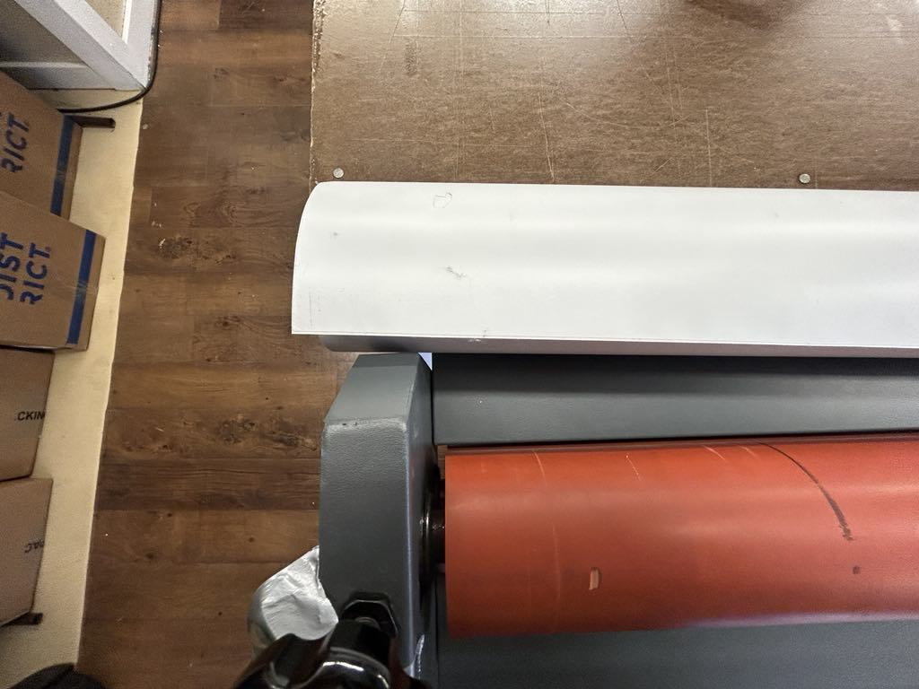

No - you cannot fit that on the laminator. My printer is 54" so I print no larger than 49ish" and then trim one side down. If you have to contour cut then you have to cut close to the registration squares.
the wood pole is to hold up the laminate after I roll it up. It's a bit redneck but it works well LOL If you need help when you get it I am happy to facetime you, just PM me.

Oh okay, I have to look for another machine, thanks for your help :)
