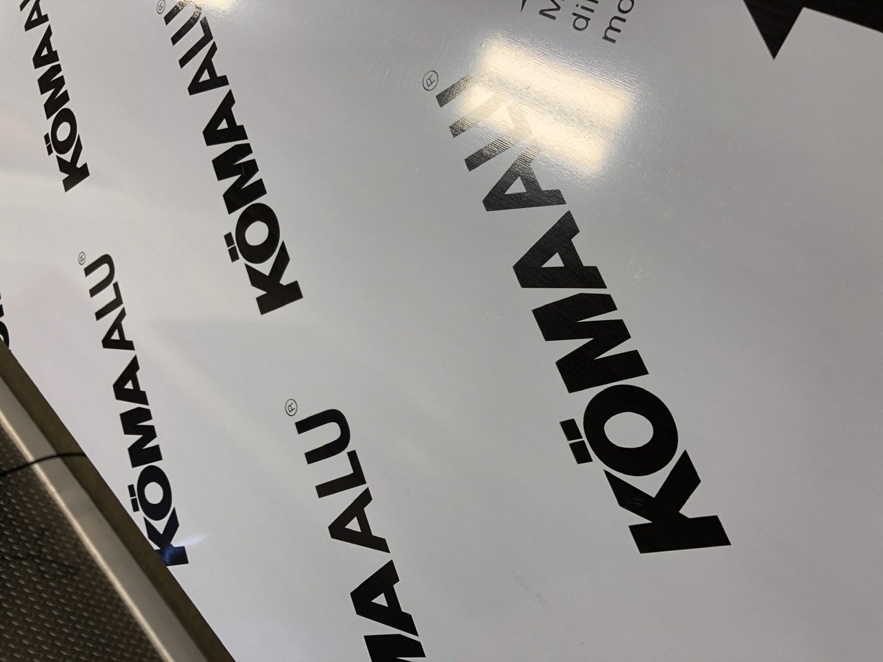

I use Kommerling’s KOMAALU® iron clad sheets. Never any issue with flaking. Never laminate it either.
