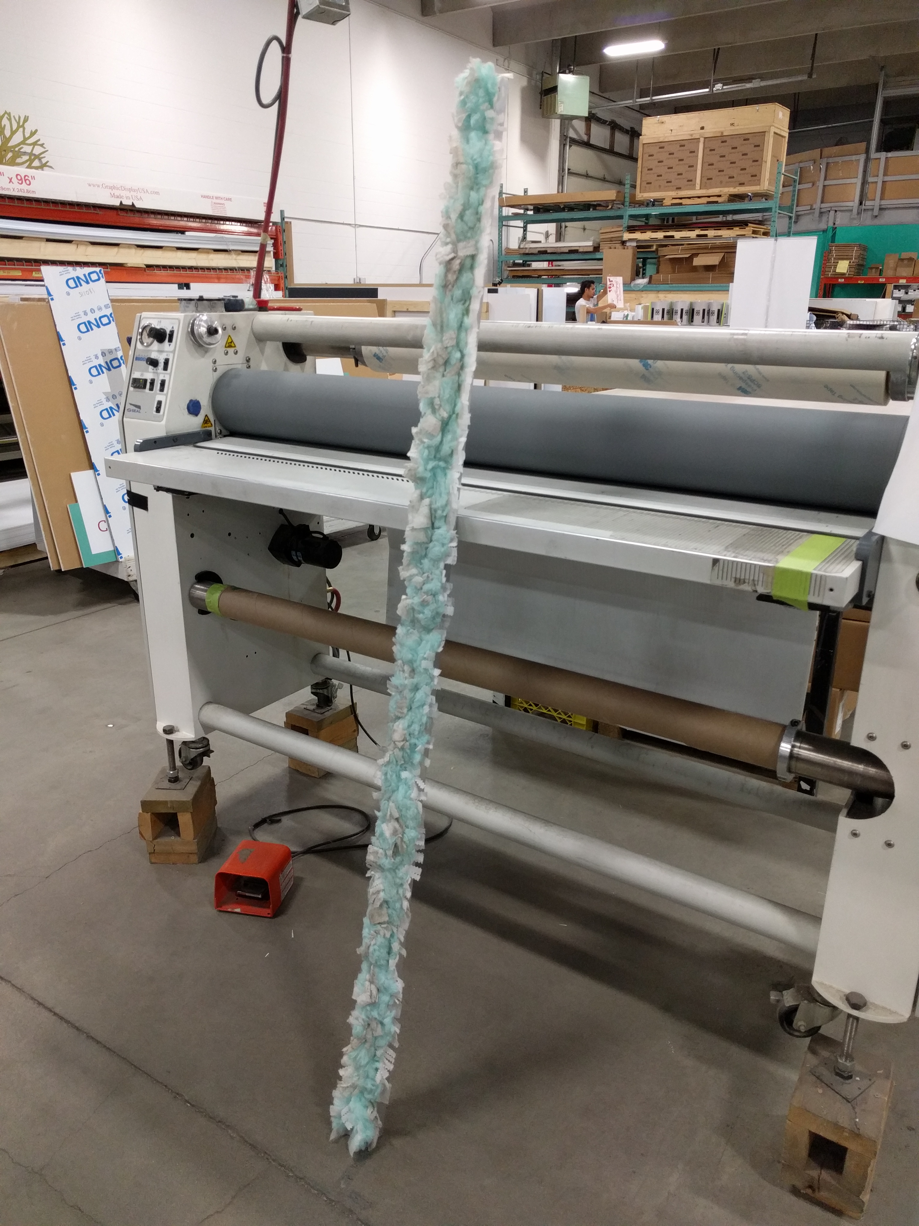

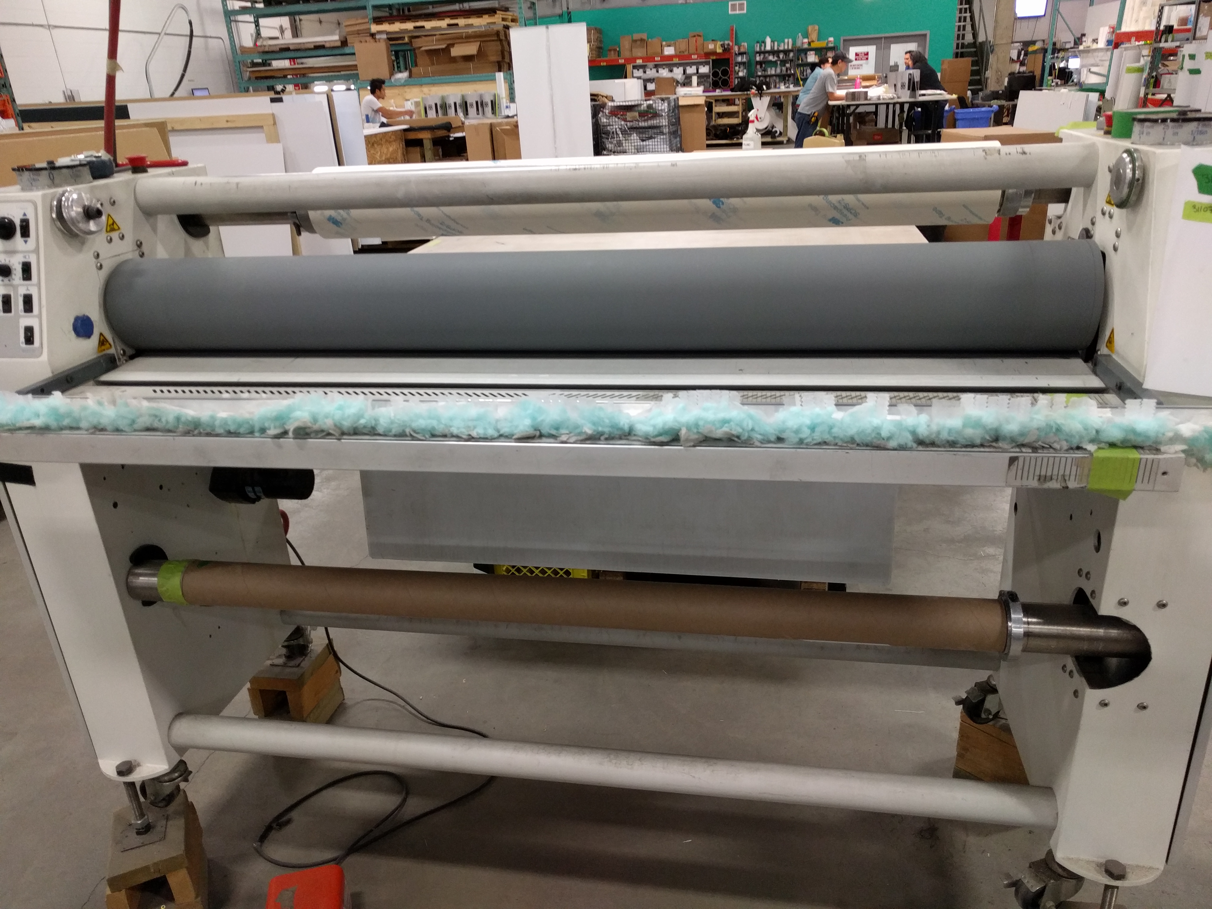

Lane J
Swiffers! They are always kept in stock here.
The guy who runs the laminator attached the swiffers to an old piece of channel bar with double sided tape. The bar stays in place while laminating and he's free to trim the sides or roll it up without worrying about dust.
We did the same thing to an old ruler that wasn't true. It works great for wiping dust off of sheets for the flatbed.
If the swiffers get too dirty, just replace them. IMG_20171120_092022.jpg IMG_20171120_092009.jpg
