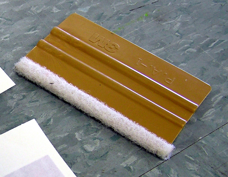

Try a Piece of Velcro
It's less stinky than your socks and isn't bothered by liquids. Use the hook side only ... not the loops. It doesn't leave a mark.
I use it on unmasked vinyl and laminate all the time. I also find I get a lot easier application of large graphics due to the cushioned effect and lower friction against the application tape.
