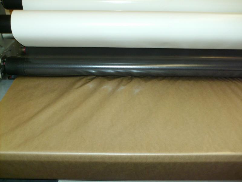

I am having some difficulties with my laminator. It's an older USI model unknown we only use with cold laminate. The problem I am having is where that the carrier paper is feeding into the pinch rollers gets pulled and wrinkled. A photo is attached below. It gets even worse as I use it, especially with narrower prints. If I laminate a 36" wide print, I have to pull it taut at the outfeed (to keep the paper from slipping and going back into the outfeed rollers), and the wrinking stays at a minimum. I am constantly having to cut it free and re-load it. It will stay smooth for a little bit, but ends up getting wrinkled within minutes. This is not a huge problem except for on occasion, the print I am laminating will get lifted up by it and cause a crease in the print, thereby ruining it.
I am pretty sure there is a half round piece missing from the front where the paper feeds over the edge of the table. I don't know if this is causing the problem or not. I can lift up very slightly on the right side of the paper roll and it helps a little, but doesn't fix it. I also have no core adaptors for the paper roll...have if jury-rigged. It holds pretty well, but could this also be causing issues? The paper does sometimes skew to the side...sometimes so bad it has to be stopped, cut, and re-aligned.
Any thoughts? All help is appreciated.
chrisberry
Well, I figured it out. I had learned how to load this from a previous employee. He was doing it wrong to begin with. After I found the manual online, I immediately saw that the paper goes UNDER the table, not over it. Duhhh.
It helps to read the manual from time to time.

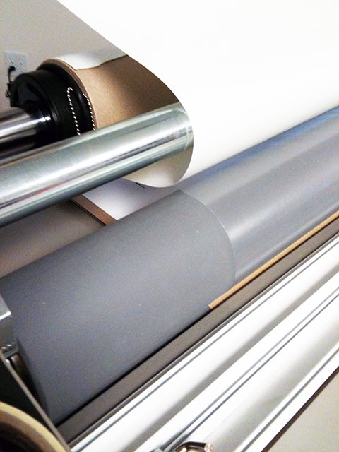

i took this picture to show how close i ran my laminator to the end of the roll yesterday, but it might help show the setup a little too. Mine is a GBC though.
I've run the laminate down to just a few inches of extra when laminating before. It feels really good when you estimate it to be exactly right. :thumb:
But it REALLY sucks when you underestimate and you run out of Lam a few inches SHY of finishing a print. :doh:
