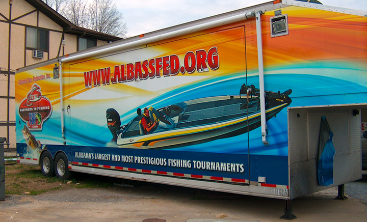

    what kind of file is it EPS, psd , jpg? there was a question on here yesterday or before about a wrap file built in flexi that was a combo of rasters and vectors and lens effects. most people do wraps entirely in PS the flatten the file to a tiff or jpg to send to the RIP. it results in a smaller file (i use JPG)
    i had a file sent to me from a national manufacturer for a 38' trailer wrap... it was saved as a eps. it had rasters and vectors combined. but even at the huge file size (both sides together totaled 800mb+) the rasters were of terrible quality. so i basically redid it PS at 72ppi and it came out great.
    saved them as jpgs about 20mb each
