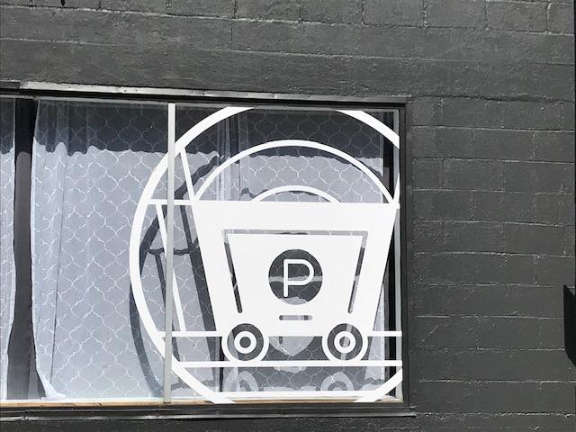

We completed the install - and the 1/4 inch overlap isn't visible at all unless you are truly looking for it. Thank you guys - really appreciated
