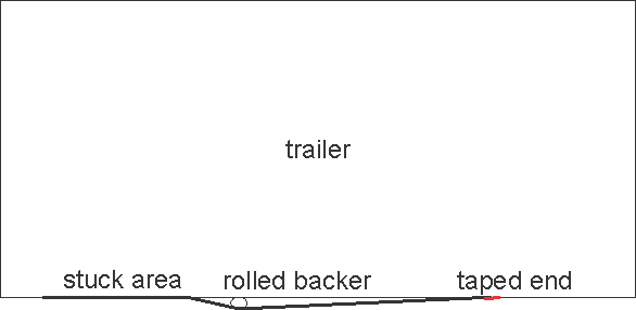

Yeah, premask on thin vinyls with air egress is a nightmare. Center hinge would work well here, though if it's 6' wide, I'd do the left foot or two, leaving the right significantly longer, so I could either roll it and remove the back as I go, or pull it taut, tape it down, then use the backer as a second set of hands to hold it off the trailer as you go.

That is a center hinge, gino just meant stick the left side then the right.
Have never taped the opposing end down, always rolled it up,
Yeah, holding a 4' tall roll up as you're looking at your squeegee is hard, this way you can stop, grab the backer, and twist, which will roll the backer up and work with a minimally exposed adhesive layer. By the time you get to the last foot or two, you can remove all the liner and work it more easily. Also, starting with a smaller area on the first half of the hinge makes that initial pull and stick that much easier. Just be sure to use plenty of tape on the far end, don't want it letting go!

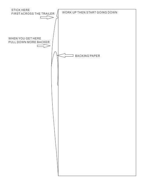

I go top to bottom, gravity is your second set of hands and there is no worry about drooping in the middle. Tape the whole top, pull the backer down about 1/4-1/2 way then work your way down using your hand to slightly pull it down and hold it tight as you work across Like burtons picture but top down.
