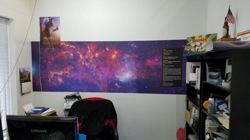

Milky Way Galactic Center from NASA's website
I agree with BlueMoonATL: check out NASA's website. I made this file 29.75" x 9" @ 600ppi, scaled it up 400% in Caldera Visual+, and it looks great.

altereddezignz
This is the exact image i am looking for lol.. everything i am finding of that one is 9725x4662 but its at 72 dpi already.
