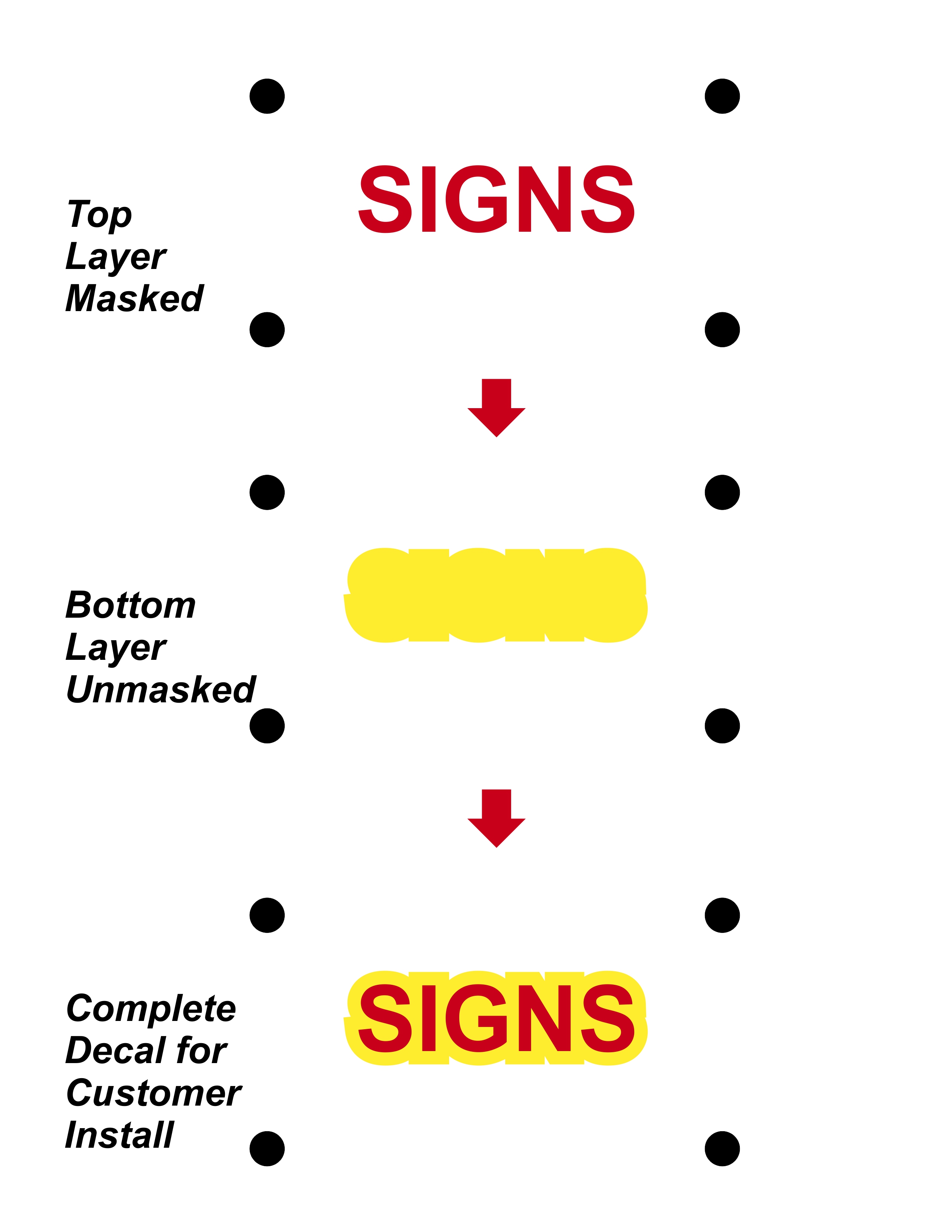

We make decals like that all the time using registration dots. Just cut small 3/4in circles or squares that match for each colored vinyl layer. Sometimes you have to peel
the app tape off one layer to apply the next till you get done but it's pretty easy. Also applying 2 layers of app tape has helped us with customer installs. It's a little
harder to get wrinkles with 2 layers of app tape.

Or just cut the matching dots on each layer and have them match the dots up for each layer while they install.
We get pretty large fleet graphics around 4ft x 10ft from companies to install on trailers and box vans and they use matching dots for each layer.
