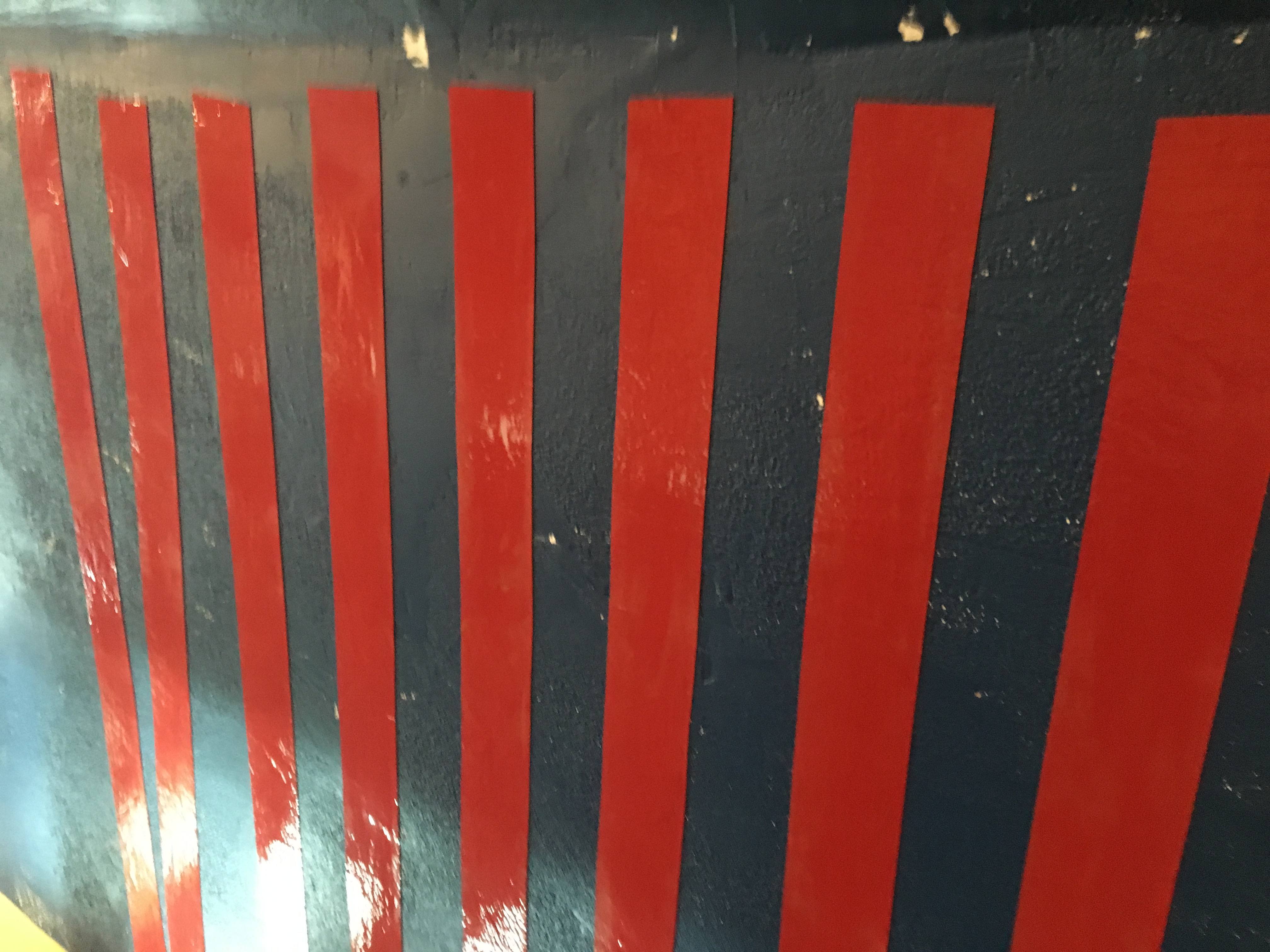

Here is the tape for the wall application.
Honestly, the only reason for backing into it all is it was assumed too be to easy friends. It wasn't about DIY to heck with pros.

View attachment 141516 Here is the tape for the wall application.

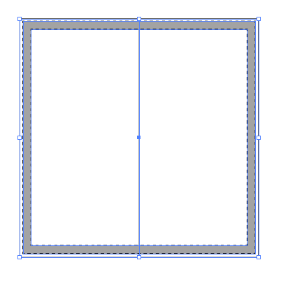

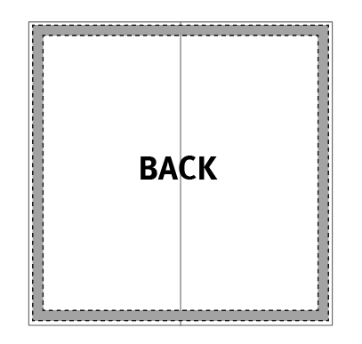

If you'd like to do this yourself then I would do this:

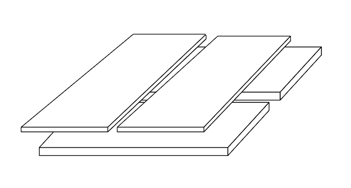

Buy more 1/2" foamcore. Glue the two half inch panels together with the top face running vertically and the bottom face running horizontally. This will make the 7' x 7' a single strong one inch thick piece.
Run one inch VHB around the circumference of the back of the piece.
Starting with the top, tape the banner and drape over the foamcore. Lay it face down and bring it around to the back and tension and tape the bottom. Start in the middle and tape outwards in both directions.
Do the same for the sides.
You will now have a "canvas wrapped" foamcore piece.
You can also do this with a staple gun and a wooden frame. Your choice.

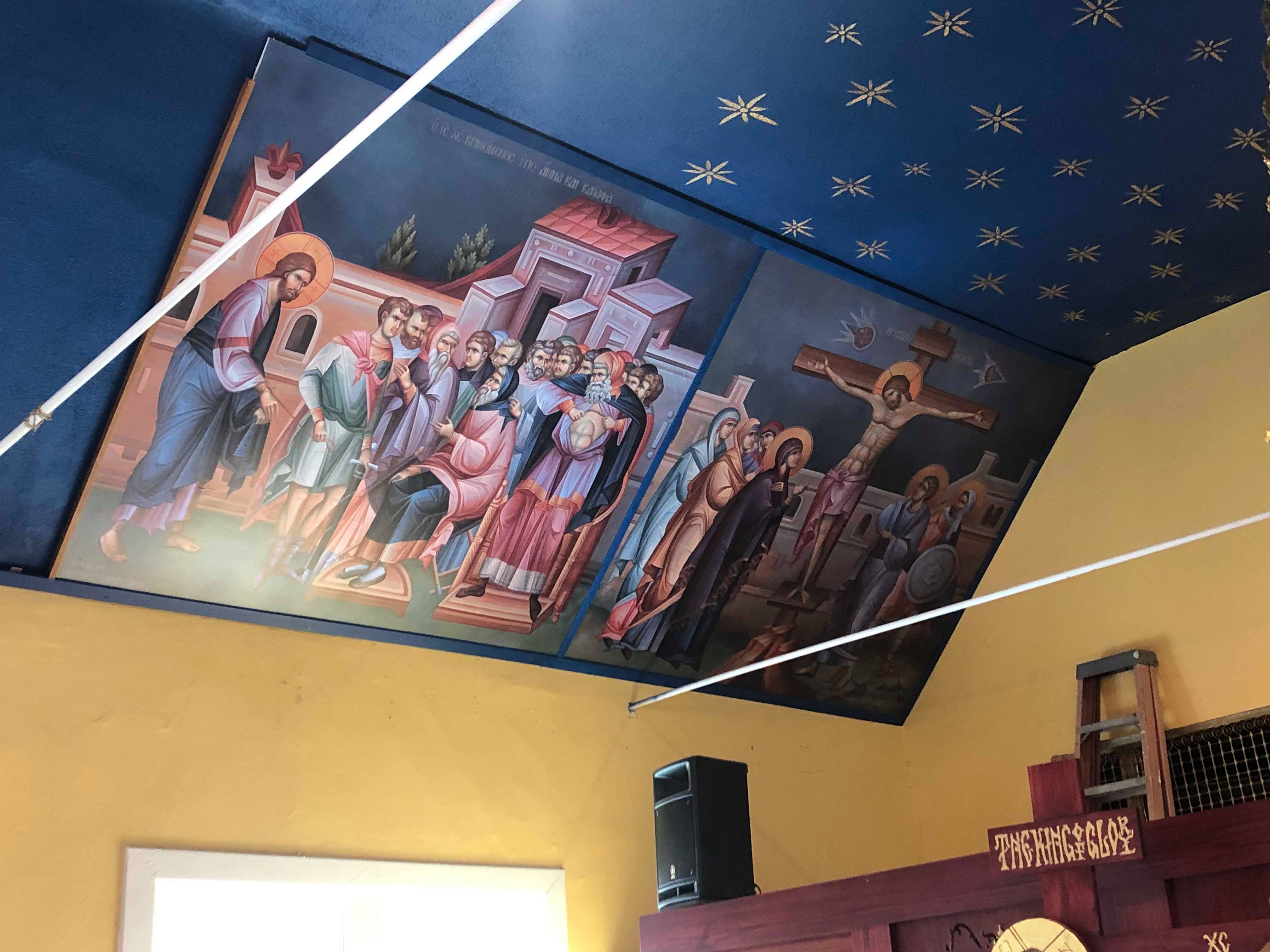

Please note, the banners are being mounted on a wall/ceiling that is roughly a 45 degree angle. The reason we did not frame mount is the middle would probably sag.

Here is a picture. You'll see we put a frame around them for a physical hold on the edges.
The one on the left had a bit of paper delam from someone lifting the edge up too far into the process. I might try to needle inject some epoxy into it. The area of paper delam is about 4"x2" or so.
There is no frame on the left side; just a margin placeholder for the next one.
