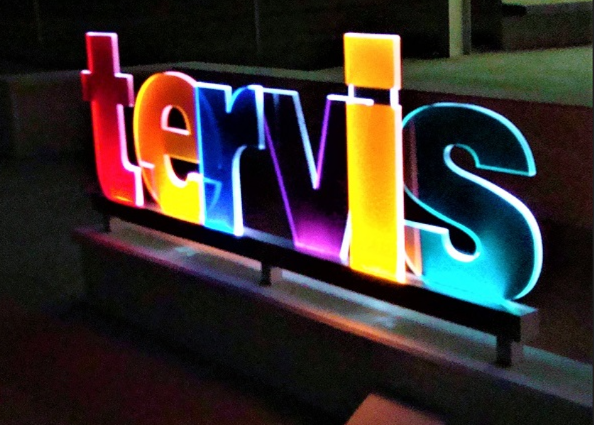

By flat letters, do you mean like this?
I didn't make this one so I don't have many details. I know it's made with clear acrylic and covered in Oracal 8300 transparent colours.
If you're doing flat letters like this on a wall with back lighting or halo, I don't think you want transparent or translucent acrylic. At night, the light will light up the letters AND the wall background. You won't get proper contrast to see the outline of the letters. At night with 3D / light box letters, the letters are lit up but there's a sharp line separating the light from the black background. Use opaque acrylic. Then at night the background will be lit up and the letters will stand out black and crisp.
