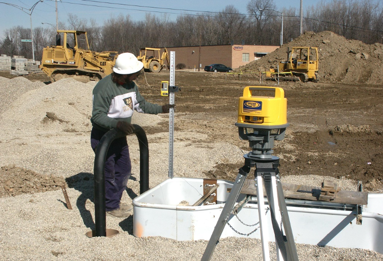

I've seen the guys around here using these two-piece leveling systems in their construction projects.
I think one device levels off the other since the laser lines aren't visible outdoors.
(this isn't my pic - just did a quick search for a visual aid)
What we were hoping to accomplish is just making leveling more efficient, or accurate. Running long signage on buildings, pylon signs, ones with oddball shapes, mainly for elevated installs where the convenience factor would just be peachy as heck. Never really came across anything made for it with the exception of the ones like this, that sight engineers use. Those need sensors to see where you're at, better for working at ground level where they're not really needed. Probably more of a pain to use up in the air than conventional levels.
