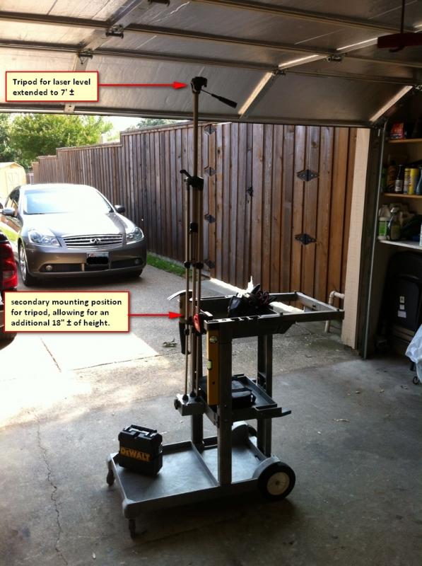

The second pic shows the setup I normally use but extended to it's maximum height. The laser gets mounted to a tripod which gets mounted to my cart. It comes in very useful when installing signs in hospitals for example, where a large number of signs are being installed at the same height.

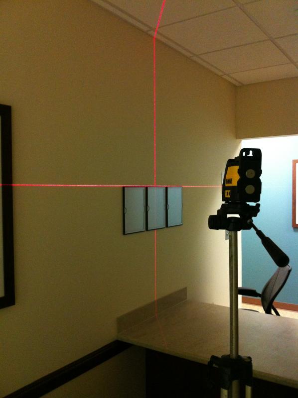

The third pic shows the laser being used to mark a repeating center and install height. I had to install 18 of these in 6 identical rooms. It made it much easier to roll into the room and hang the center plaque where it needed to be and subsequently the other two.
